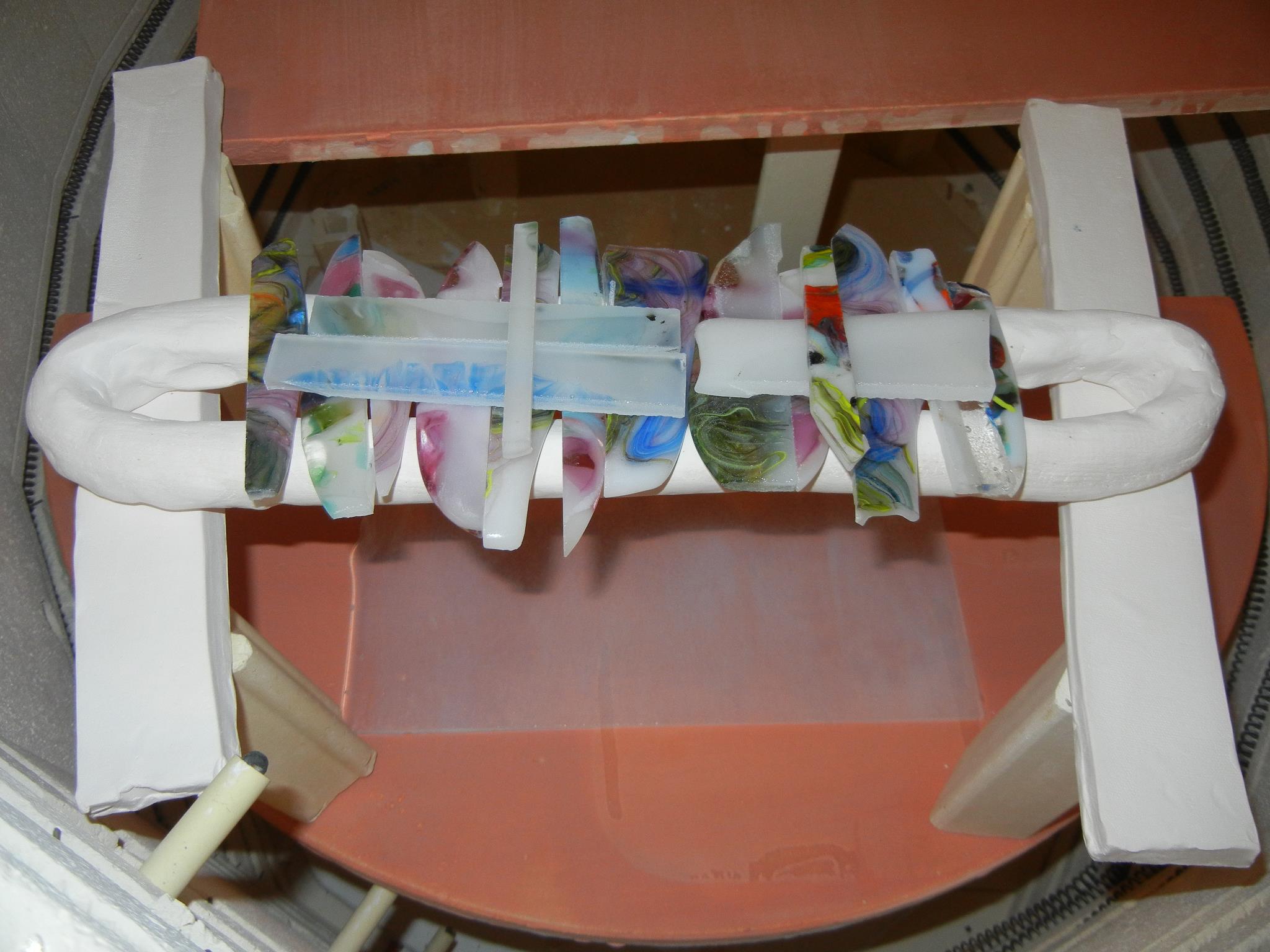

This drop in this student's piece didn't need to be this high. The goal was to get it to fill up the translucent white onto which it was dropping, with a finished piece being consistent 6mm. I post this photo to show the use of clay instead of metal for drops. The hold required for leveling it all out to 6mm allows all but the tiniest film of glass to drop off the clay. All reusable. No clay in glass.
