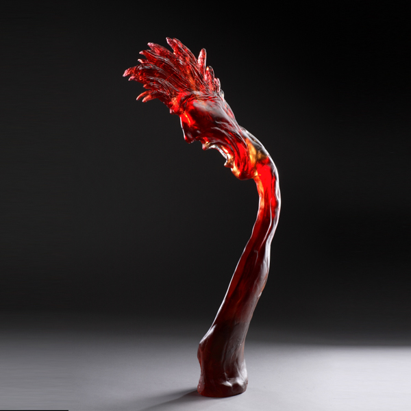

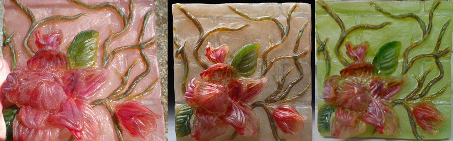

This is a 9-inch pate de verre tile, where the background is pure powdered transparent Rhubarb Pink-Green to about 1/4 inch, then a mix of powdered Rhubarb against crystal clear fine frit as filler. It's displayed, variously, in summer sunlight, incandescent light (bronze), and fluorescent lights, so that background goes all the way from candy pink to bronze to lime green: In Shout, though, I'm mixing Rhubarb billet with my second-favorite BE casting color, Burnt Scarlett Striker, and it completely changes character: It deepens the scarlet tones and really starts to glow a deep, fiery red: That is, it glows red until you get it into fluorescent light. At that point, the whole sculpture does this bilious green thing that nearly made me rename it "Hangover."
