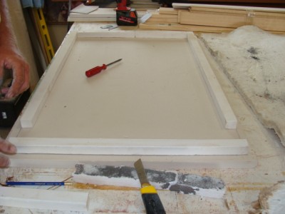

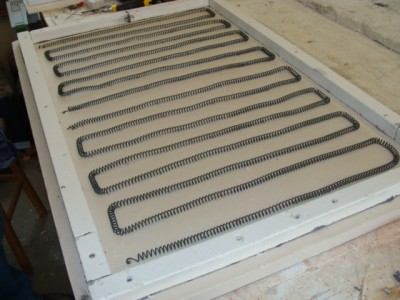

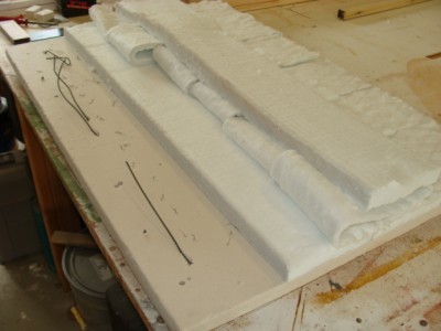

This seems to be a recurring problem with kilns with brick lids. I've never had one so am only guessing that the problem might be addressed by revising the way the element is held in the lid. Recently my brick kiln needed the lid rewired. As this is a
home-
made kiln we just repeated what was done originally and I took photos in case they could help someone else. There has never been a problem with anything falling from the lid.
Would it be possible to do away with the brick in the lid and replace it with Ceramaguard or some other suitable high density fibreboard? I don't know what holds the brick in place in the kilns that are causing so much grief but a slight modification might allow the change. One of the nice things about HD fibreboard is the fact that it can easily be cut to any shape. Here are some photos. This is a rectangular lid but it could be any shape.
- New lid liner prep viewed from underside. Note the 25 mil Ceramic fibreboard. The strips will be attached and they seal the lid when it closes.
- new lid liner viewed from underneath with elements reinstalled. The elements are held snug to the liner with 'u' shaped wire loops poked through from the underside and bent at 90 deg. on top so they don't dislodge.
- Flipped right side up. The element ends are poking through. The little marks that look like ants are the bent ends of the wires securing the elements. Ceramic fibre blanket covers it and insulates it from the expanded metal lid. The element ends were brought up safely to the connectors in an enclosure on top of the expanded metal lid.
