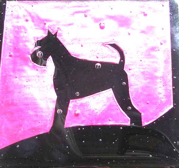

I've been using the exact same program and the same materials for a couple of years, and I've noticed that I'm getting more bubbles in my work recently. Could this be somehow due to having an oldish kiln? I can't think what has changed that would do this. I work with black glass, then copper then capped with clear.
The only thing that has changed is my cleaning method. I no longer use water and bubbles and then spray with glass cleaner, I just use glass cleaner which has helped with devit.
K
K

Re: New bubbles that weren't occuring before
Hi,
I used to use Ecover - environmentally friendly washing up liquid, then I'd dry and spray and clean with Bohle glass cleaner. The problem was that a lot of pieces had a haze over them, so I started to ditch the washing-up-liquid and just use the glass cleaner, this has worked well so far as the end result is nice and shiny. But now I am having bubble problems, there are noticeably more bubbles and a lot of my pieces are wasted. But saying that, this didn't happen over night when I ditched the liquid it has happened over the last couple of weeks.
I am wondering if the paper towels I am using to clean my work with the glass cleaner have left 'bits' on the glass as I noticed they seemed quite dusty to use.
Also, although I have used the same schedule for 2 years, I'm wondering whether to change it to help eliminate bubbles, as during this time I've had a lot of pieces wasted though bubbles. Most of my work involves two pieces of glass with copper sandwiched between.
My schedule is 330 to 750 hold 10, 500 to 1150 hold 30 then 200 to 1250 and hold for 2hours. Would it help do you think if I slowed to 250 to 1100 then slowed right down to 50 to 1250?
Thanks
Thanks

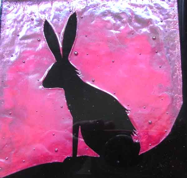

Hi thanks for getting back to me, I am using bullseye glass.
You should be able to see the hare - this is an old piece that I kept as the design was wrong, but as you can see where the silhouette is (black) there are hardly any bubbles, but if you look at the dog - which has just come out of the kiln, there are lots of big bubbles - I didn't get this before, or rarely, especially with the dog.
For a couple of years I fired my pieces with no problems except the odd failure, now I am getting lots of failures. I can't understand what I am doing wrong. Perhaps my kiln is getting old?
I am using the same copper as before from the same place.
Karen
Karen

I'm pretty sure it's not the shelf as the air is trapped between the glass not under the glass.
I have been making coasters like this for 2-3 years and experimented widely. I did try chips of glass and firing upside down, but neither helped.
What I did in the end is revised my designs to minimalise bubbles. So the dog design you see was coming out fine each firing for at least a year or two, so I can't work out why it's not working now. I fired 6 and only 2 were good
I will revise my schedule and suggested.
I'll slow the rate to 1250F, should I still hold for 2 hours here?
Thanks.
Thanks.

The copper is pretty thin, almost rippable. It is usually pretty flat, I think the picture distorts it as it's not that wrinkly!
Thanks for your help.

I've found that it is impossible to get rid of all the bubbles, so I am happy to live with them - but it's only recently they have become so large on so many pieces.
Anyway, this firing I really smoothed down the copper, and slowed down the rate right down to 1250, and the results were a lot better - out of 6 coasters, one was a bit spoilt through bubbles - so quite a good result. Morganica, I am using Bullseye black opal and tektra clear. How would you clean the copper? I did have a stage where I scrubbed the copper with a green scouer, I'm not sure if it stopped the bubbles, it did make the copper look different though.
Stephen, I use glasstac to hold the copper down as it's hard to get the clear cap on without moving the copper slightly, I use sparingly. I don't wait for it to dry, just the stickyness holds the copper in place.This firing, I did use less, but I still used it. I was told (on this board?) some year's ago that using glasstac shouldn't make any difference to bubbles. Could this be adding to my bubble problems? It's strange, but this new bottle does seem really runny.
Thanks
K
Thanks
K

I'm guessing that where I've slowed down the speed from 200 to 50 going to 1250 this is causing the copper to get too hot. It must be this as it hasn't done this before.
I'm going to experiment with speeding up a wee bit.
Thanks. K
I've just made a batch that have come out bubbless! I have a new problem now though - but minor compared to the bubbles - the copper is now burning too hot and turning blue...
Thanks. K
