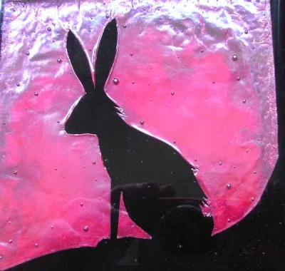

I've been using the exact same program and the same materials for a couple of years, and I've noticed that I'm getting more bubbles in my work recently. Could this be somehow due to having an oldish kiln? I can't think what has changed that would do this. I work with black glass, then copper then capped with clear.
The only thing that has changed is my cleaning method. I no longer use water and bubbles and then spray with glass cleaner, I just use glass cleaner which has helped with devit.
K
K

Hi thanks for getting back to me, I am using bullseye glass.
You should be able to see the hare - this is an old piece that I kept as the design was wrong, but as you can see where the silhouette is (black) there are hardly any bubbles, but if you look at the dog - which has just come out of the kiln, there are lots of big bubbles - I didn't get this before, or rarely, especially with the dog.
For a couple of years I fired my pieces with no problems except the odd failure, now I am getting lots of failures. I can't understand what I am doing wrong. Perhaps my kiln is getting old?

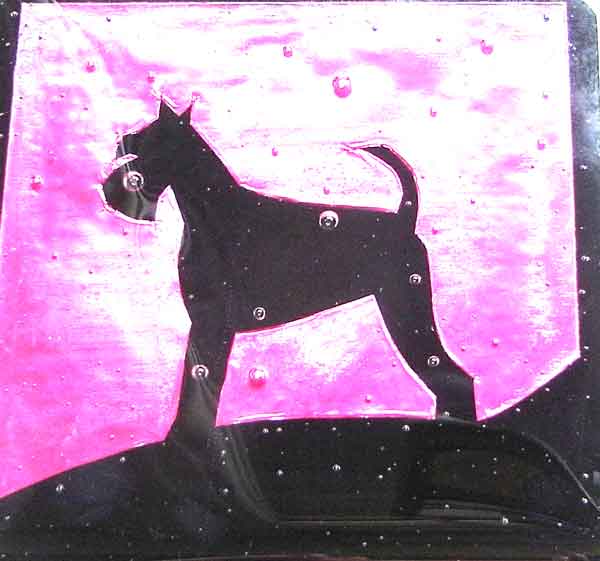

I'm pretty sure it's not the shelf as the air is trapped between the glass not under the glass.
I have been making coasters like this for 2-3 years and experimented widely. I did try chips of glass and firing upside down, but neither helped.
What I did in the end is revised my designs to minimalise bubbles. So the dog design you see was coming out fine each firing for at least a year or two, so I can't work out why it's not working now. I fired 6 and only 2 were good

The copper is pretty thin, almost rippable. It is usually pretty flat, I think the picture distorts it as it's not that wrinkly!
