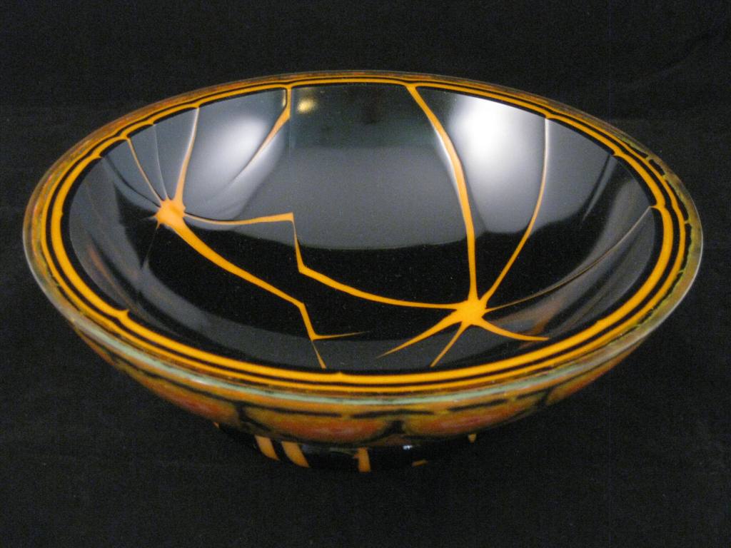

How big are these, not that it matters at all as they are stunning

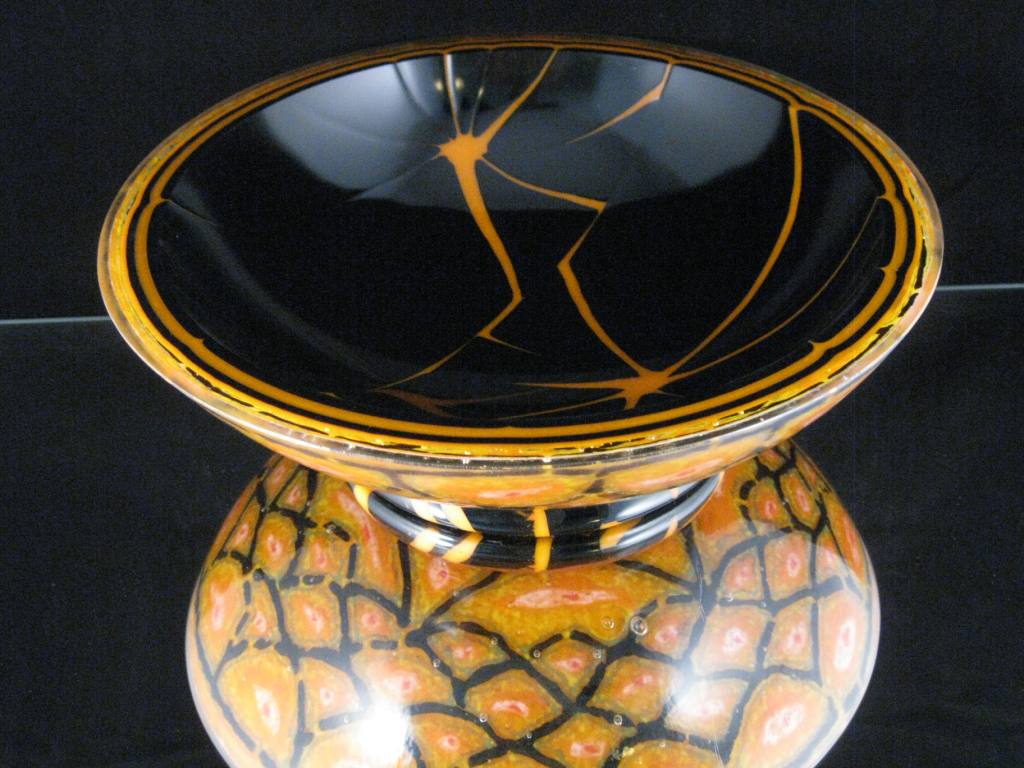

WOW! It is BEAUTIFUL and I am intrigued! I am curious as to what techniques you used...not to copy or recreate but to understand?

What a wonderfully elegant piece. I really appreciate the layering/depth and your edge work. Very nicely done!
I also really like the few, small bubbles on the back. They are like little punctuation marks

For those that have asked, the bowl is 12 inches across and about 3-1/2 inches deep. It started as stringer medium pattern on clear filled with powders placed on 2 layers of thin black and orange and fired. Broken black then placed with another orange layer on top, topped by already fired piece and capped with clear and fired. Flip fired to reduce some bubbles, slumped and coldworked. Thank you all for the feedback. It is greatly appreciated. Tim
