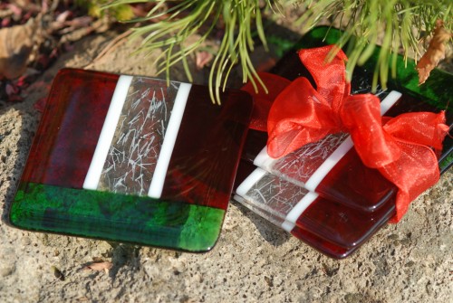

callidesigns
- Posts: 4
- Joined: Wed Nov 07, 2012 3:51 pm
Re: Baked on Kiln Wash
Thanks to you nice people for your suggestions. I feel that I learned a little sumptin here and am glad that I got up my nerve and joined all of you fine artists. Here are pics of the coasters after coldworking with the diamond pads and a fire polish.
