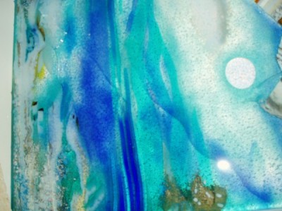

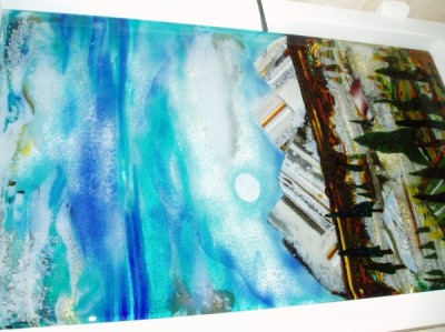

Hello! I am creating a large 30 inch by 17 inch by 1 inch thick cast panel that had a sad thing happen today. I have created many of these pieces and well, BC Hydro came by and said they had to turn off the streets power to fix a transformer and I begged them to waite a few days but alas they could not. My kiln was on it's way down and had just annealed and was at 898 deg. F. It dropped 50 deg. in the 10 minutes that the power was out. When it came back on I quickly set a new program to go up to 1100 Deg. F. and then back down to 900 Deg F. to anneal again and start the slow ramp to room temp. Do you think it will be O.K. I am not optimistic but worry even if it does survive, can I chance it going out on the market. What are your resource teams thoughts. I look forward to hearing from the experts and will thankyou from my heart for the information.

The piece was similiar to this one

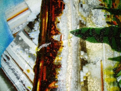

Just when you think you have solved a power outage problem my haste did not help in reheating to 1100 F. AND well the piece DID thermal shock from tooooo quick a temp rise to 1100 F. Soooooooo now I have added MORE glass and will attempt again to refire. Not feeling optimistic BUT am taking 24 hours up to 1220 (my lucky number. Hmmm eh!) holding for 2 hours to get things warm and even. Then up to 1480 and the rest is the same as always. I will keep you posted. I covered all the fracture lines and hope it will look sort of O.K. Did not like the trees anyways.
