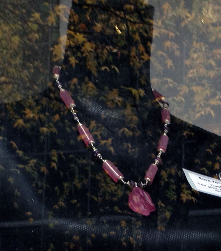

The walls must be fairly thick for the tile nippers to work. I have much better luck with the tile saw. I set up a jig on the saw (so they all come out the same length), gang up a few cane, and start slicing. As long as you've got a good blade on your tilesaw they cut pretty well. The ones that shatter are probably too thin (or stressed) to hold up in jewelry anyway.
Once you've cut them, put some wet-dry sandpaper on a padded board and run the edges back and forth a few times to soften them, then stick more sandpaper on a thin dowel and soften the inside edge (so it doesn't cut into the cord/chain you're using). That's pretty much it. If the edges are going to show, you can continue with finer grits and then polish, but I generally cap the ends with metal spacers or gem rondels, so it's not really necessary.
I like to make my own chain when I'm incorporating my cast pendants into necklaces, and the hollows are nice because they've got a built-in hole for the wire to go through. Cap each end, terminate the wire on both sides with loops, and you've got a nice link for your chain. Unfortunately, I've only got a really bad photo of one, but here 'tis: I took Nathan Sandberg's Venetian cane pulling class (it's an amazing (and very fun) class, if you get a chance to take it, you should), and was horrified to find most of the students' hollow cane going into the trash. I asked permission to dumpster dive for it and came away with an absolutely glorious collection, enough for a dozen necklaces.

Re: Glass Straws
Very nice necklace.

Cynthia,
Thanks very much for your detailed explanation. I really appreciate it! Very nice necklace!
