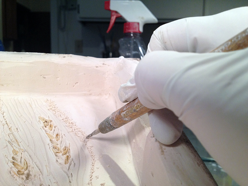

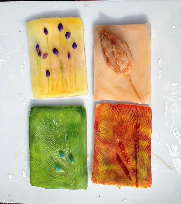

What plasters are you using, how much manipulation are we talking about, how long after demolding? I carve into the plaster for pieces like this and have about a 4-hour working window after demold:
The two pieces on the bottom (this is straight out of the kiln, without coldworking) are carved after cleaning out the mold, to get the swirly line texture. I'm using plain old pottery plaster/silica flour in a 60:40 ratio (sorta--there are additives), demolding and cleaning it up, then going into do the texture carving.
I've tried retarding the plaster set by putting maybe a quarter-cup of vinegar per half-gallon of water (or so), and then chilling the mixture to well below room temp. It increased the set time but I didn't clock exactly how much--probably 30-40 minutes, but the mold seemed weaker as well. I only did it the one time, didn't think it worth the trouble.
One thing about carving into a refractory mold; it works well for straight plaster/silica mixes but in my experience it can cut through the smooth "skin" that some mold mixes form, down to a sandier layer below that can embed into your glass and be a pain to remove.
