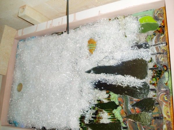

I would be very grateful if someone would tell me the melting or fusing temperature of BE powder tekta 1101 and/ or clear transparent powder 1401.
Additionally, I would be grateful to know the melting / fusing temperature of fine frit 01 grind again, of tekta BE1101 and / or clear transparent 1401.
I need to know this in order to know how high. Do I need to get if I cap a piece with powder or fine frit.
Many thanks in advance
