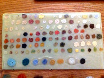

I ran a test with 110 mica powders and found that most of them lost color at fusing temps. I did find a few winners though... I only tested capped and have been told the colors will act differently uncapped. I dread running this test again (uncapped this time). does anyone have any input for me on this? specifically uncapped mica keeping color?

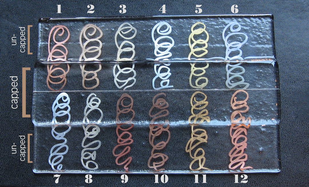

Running lots of tests and taking good notes is instrumental to learning, especially since what works in one kiln may behave very differently in another.
Brad asked good questions, since mica quality is another variable.
Here's a test piece I did several year ago with mica from C&R Loo:

I tested some Pearlex, TKB Trading, Perfect Pearls. went to 1490 and used hairspray as my medium. if anyone is interested I could post the info for the"winners".

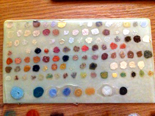

I tested about 110 mica powders - only a few kept their color at 1490.
I only tested capped, and have been told results will be different uncapped.
Here are my results:
Blue: I tested 16 blues and none stayed blue.
Purple: I tested 11 purples and none really stayed purple.
Pink: none stayed pink.
Green: I tested 17 greens. Pearlex Spring Green stayed about the same shade of green.
Red: none actually are true red, however very nice vibrant color with TKB Hot Step Mama, Pearlex Duo Red/Blue, and TKB Queen Kathryn.
Yellow: Pearlex Duo Green/Yellow fired goldish yellow.
Copper: TKB Passion Orange is a beautiful rich metallic orangey copper, TKB Lovely Leo is a lighter copper, TKB Bronze Mica is slightly tarnished understated but still rich copper, Pearlex Antique Copper is a nice tarnished penny color, Pearlex Super Copper is vibrant.
Gold: the best truest gold is Pearlex Aztec Gold. TKB Verdigris Gold is nice dark antique gold, Pearlex Interference Gold is a whitish sparkly gold, TKB Pisces starts out blue but strikes to a brilliant yellow gold, TKB Aztec Gold is a nice strong coppery gold.
Brown: TKB Swiss Chocolate is a nice rich dark brown.
White: the truest white is Pearlex Micro Pearl.
Silver: none fabulous, most sparkly brightest silver Pearlex Pearl White,Pearlex Macro Pearl a little darker but still shiny silver, Pearlex Antique Silver tarnished silver but appears to have burned away a little.
Miscellaneous:
TKB Sapphire strikes to a darkish but unsaturated lavender.
Pearlex True Blue strikes to a pale silvery lavender,
Flexi Glass Silver is really more of a metallic off-white.
Mona Lisa Bronze turned khaki with an even coating of bubbles.
TKB Patagonia is a pretty brownish plum.

Haley, I didn't test any TKB whites, only Pearlex. see my photo, 2nd row, last 3. Macro Pearl came out a medium sparkly silver, Micro Pearl came out white, and Pearl White came out a light silver.
