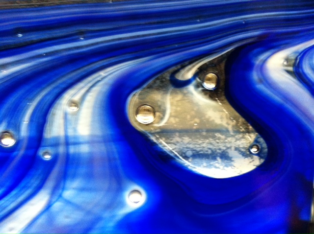

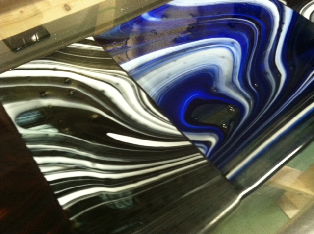

Bubbles that were about 3/8" diameter. I washed with soap and water, maybe I didn't rinse well enough.

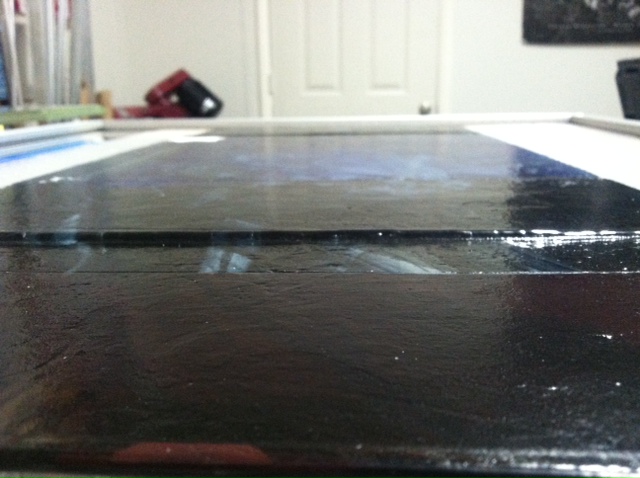

Unsure if the surface finish/texture on the back of the glass is normal or if I can remedy the situation.

It is hard for me to tell from the pictures if there is devit......i do however see the bubbles.
I can't read your schedule unless it is translated to F. So I am no help there.....
Did you do a bubble squeeze? Spectrum glass is so flat you should not be getting these bubbles if fired correctly.
- Posts: 774
Re: Is this devit?
baroque isn't flat. Air bubbles are likely.

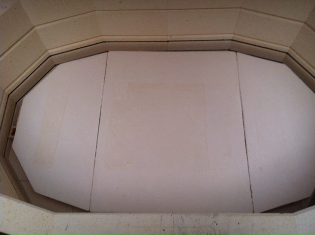

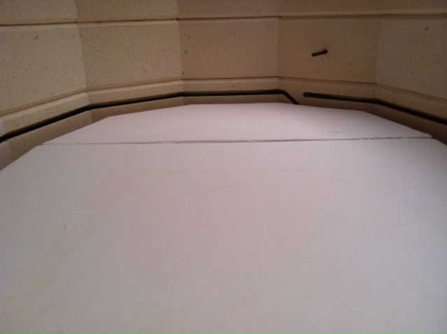

It might be worth mentioning that I have to use three different sections make up my shelf and the entire surface wasn't flat. I didn't notice until afterwards, but it caused a 1/8" ridge to rise on the bottom of the glass, very near to where there is a concentration of bubbles.

Joel....The only way to fire across a 3 section kiln like that and not have a ridge is to either
Get a full board of fiber board and cut it to the size of your kiln
Use a blanket like I think Bert does
or avoid the cracks

850 degrees an hour- 1535 hold 20 too hot way way too fast -- no bubble squeeze

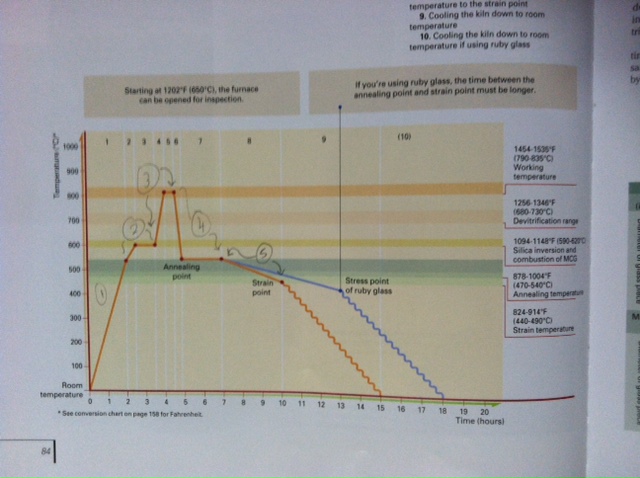

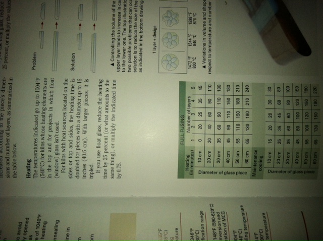

I'm pretty sure the conversion is correct, sorry about the formatting. I'll attach a pic of the chart i used, hopefully it's readable. There was an additional chart to add time for larger pieces, etc., so I probably just misinterpreted or miscalculated something. Of course Cent isn't my native language either, so theres always that.
Thanks for your help, I think i'm going to find a reference for a schedule on warmglass and keep the size of the work small enough to fit on the shelf.

Conversions for those who can't use the little tool that Brad has provided for us at the top of each page - i.e. no excuse for anyone to say they can't read F or C temperature.
Temp (deg C) Rate (deg C/hr) Hold (hr.min)
0 - 540 1005c 90 162/hr 0.0
540 - 600 1113c 135 243/hr 1.0
600 - 835 1535c 470 847/hr 0.25
835 - 540 AFAP 3.00
540 - 490 915c 13 23c/hr 4.00
490 - room 96 173/hr 5.00
Thanks
You initial rate of advance is much slower than needed. You could go at 220C/hr (for up to 6mm thick) to a bubble squeeze around 630-650 (for S96).
795C or 800C is high enough for Spectrum. Your bubbles may come from thin or over-fired glass or both.
In the days when I messed around with spectrum, I found baroque very prone to devit.
The annealing point for S96 is about 513C and 30 minutes would be enough.
80C/hr to 370 would be an appropriate annealing cool rate.
Spectrum transparents are pretty good for fusing, but the opalescents, wispies, and Baroques are not so good. The transparents all are fine for finding out how glass reacts in different firings. But do not expect fine work from glass that is not tested compatible.
