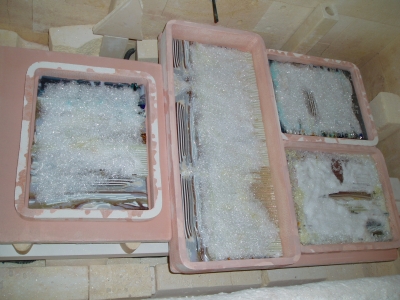

#1 Colour Bar Containment Moldsjpeg.jpg (99.91 KiB) Viewed 21161 times
I know that the idea of this thread was to talk about less expensive dams but I just thought I would share this as I have used these dams for almost 10 years and all you do it prime them and they do not thermal shock or you do not have to use fiber blanket or anything and they just slip off afterwards. Yes it is a Zircar product and some find it expensive BUT at the end of the day it is fabulous for quick set up , no bracing necessary and always the same size of glass panel every time. Just thought I would share this alternative idea.

twin vision glass wrote:
Yes it is a Zircar product and some find it expensive BUT at the end of the day it is fabulous for quick set up , no bracing necessary and always the same size of glass panel every time. Les
Hi Les.
Thanks for sharing.
Ive had a look at the zircar products website and they have many refractory type products. Can you please tell me the name of this product?
Pete
Peter Angel
Re: ceramic and porcelain tiles as dams?
http://www.zrci.com/rs101.htm
This site might help out or call Zircar and let them know it is a Glass Containment Mold you would like. You must tell them that it is sooooo important to polish the bottom side completely flat and THE INSIDE) . Usually the molds they have singles of are : 19 ich x 10 inch x 1/2 inch. (the larger one you see in the photo. You can get them in different hights and I use 1 inch one and 2 inch ones and 3 inchs ones for colour bars or other things. Mike Cauda is the contact person: and let him know I totally suggested the polishing of bottom and inside or do not purchase. Other wise you will have problems. Yes the cost is above $100.00 each BUT I have had them for years. You MUST fire out first and then ALWAYS prime them every time you use them. Gentle sanding after usage. If taken care of they should just simply slide off!!!!!!!!!!!!! Yeah! Then slice away.

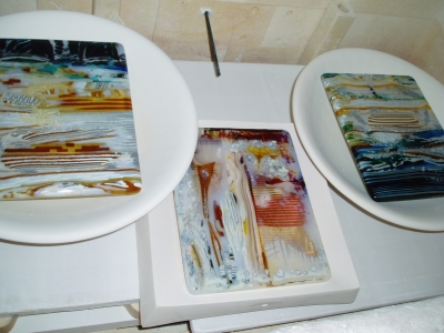

Colour Bar Bowls slumpingjpeg.jpg (95.26 KiB) Viewed 21120 times
Well no fuss no muss and no grinding. Out of mold into mold :roll:
