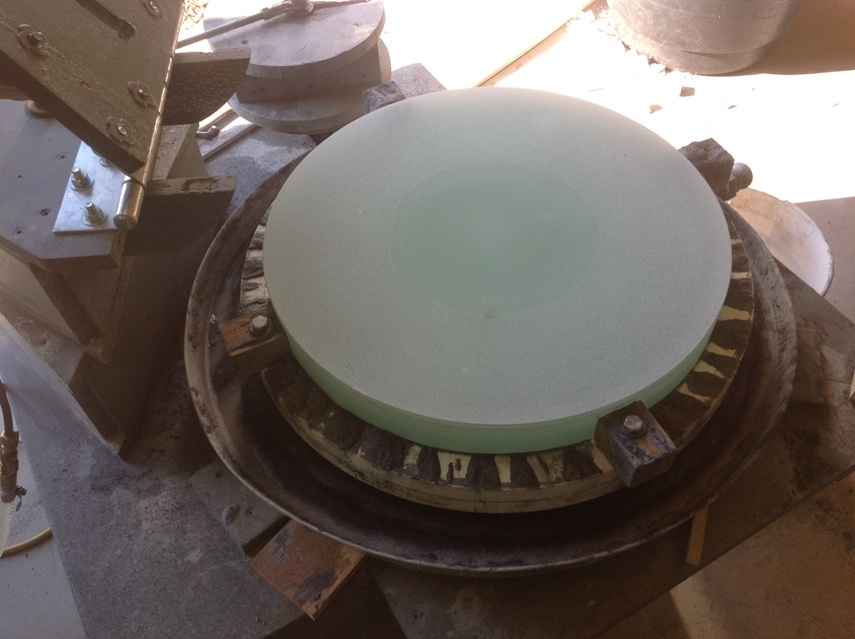

Ron Behrens
- Posts: 38
- Joined: Wed Jul 24, 2013 8:07 pm
Re: Quenching melted float glass
This is one I made and am grinding. I need to improve my success rate. I am going to try using some broken glass in a flower pot next and see what happens.

Ron- Can't you buy cast blanks specifically for lenses? I understand the DIY part but is it cost-efficient (or doesn't it matter)?
Ron Behrens
- Posts: 38
32 and larger can have prohibitive wait times. Larger mirror blanks can become exponentially more expensive. Also when you add the complexity of slumping a meniscus blank it starts to make sense to make ones own. Plus all my life I have enjoyed tackling and completing difficult projects. And when retirement comes around it could offer an opportunity to make some cash
