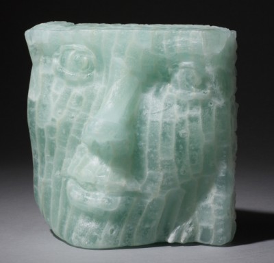

Thanks Cynthia, for posting those awesome images of that cast face again, I had meant to praise the work the first time I saw them sometime last year. peace- haydo
