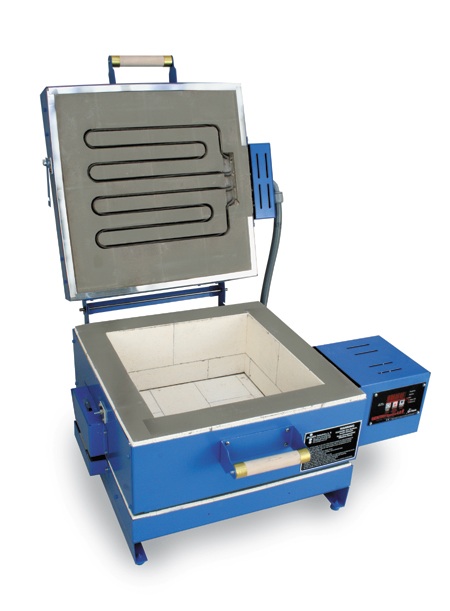

The outer demensions are 30x30 and it is 186 lbs.
I have been looking through the Harbor Freight site in hope of finding something but I'm not sure what would work.

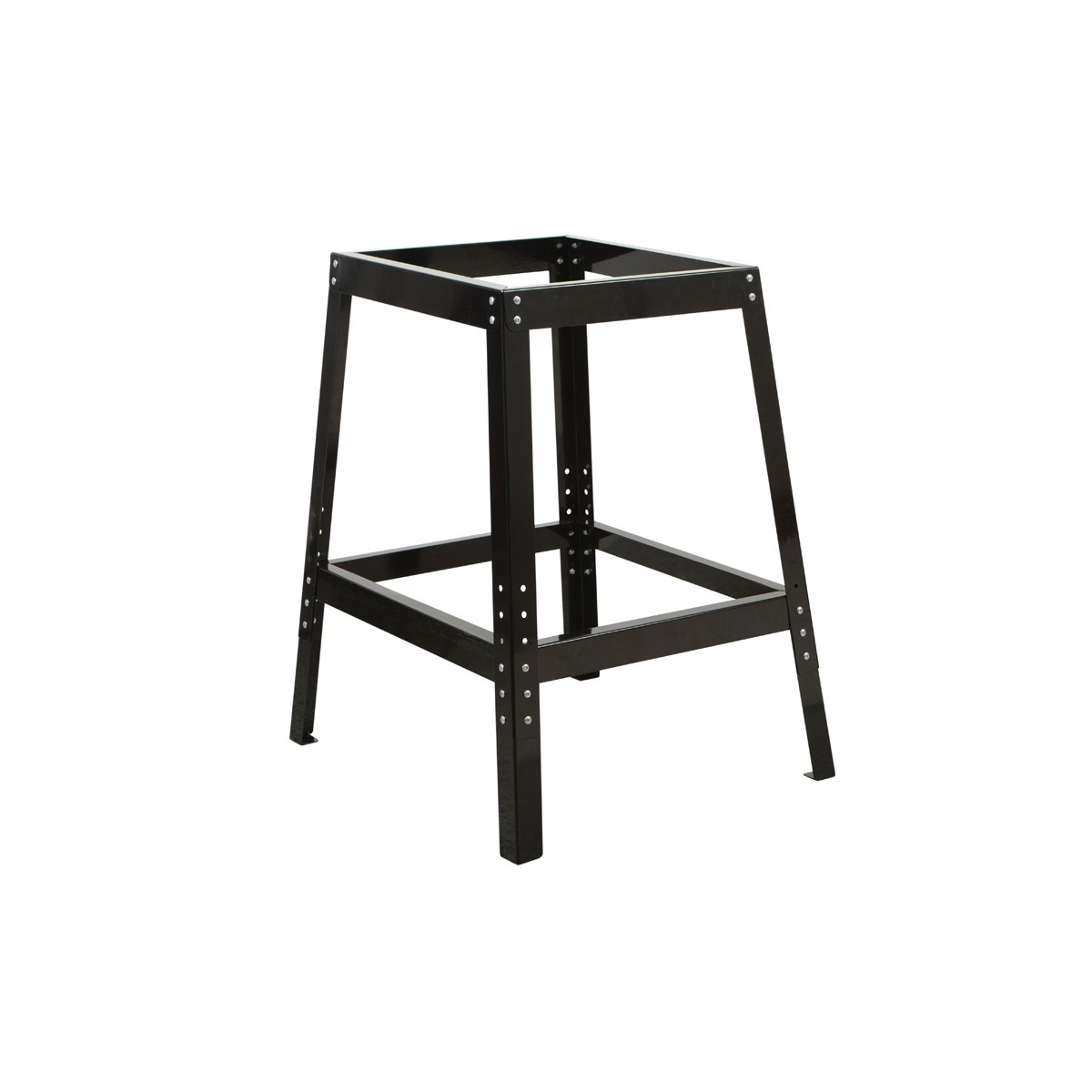

Would this work? $35
I would need to put a surface on top, is it safe to use plywood?
Rated to 500 pounds (with HF I just cut the number in half to be safe but 250 should be enough, I think).
18-3/8" x 20-1/2" (Top)
Up to 25.2" x 27.16" (Base–Leg Spread)
26-32" height
Looks like it might be a pain to put on castors, because of the way the kiln opens from the bottom it needs to be pretty far from the wall, but when opened by the upper hinge it can be much closer, so castors would be nice. HF has a kit but it cost more than the stand itself, $40
26-32" height

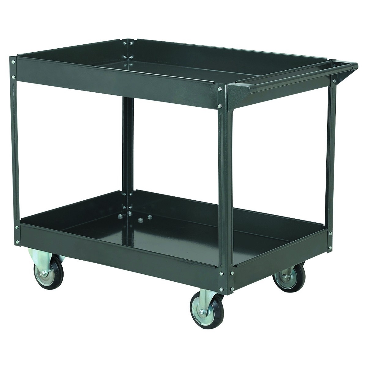

Also thought about this cart. Rated to 450lbs, all steel.
I looked at the instructions for putting it together and it looks like I could flip the top shelf to get rid of the lip.
24x36
$60
24x36
$60

I've got the HarborFreight stand you're picturing and I would think it would be a bit topheavy with a kiln unless you put a shelf on the bottom rungs and kept something heavy on it. I also have the cart (HarborFreight forever!), and I'm not sure you could turn the tray upside down without weakening the support. You could either fill up the tray with lightweight firebrick and set the kiln on top, or just secure the backerboard to the cart and put the kiln on it.
