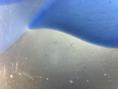

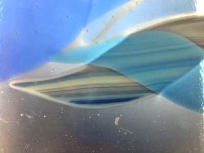

Lani's info was excellent- thanks.. and very valuable to me was "Chips that exceed this extreme level of stress will actually break out of the bar – at which point the stress is relieved by cracking and no halo will be visible. " I am not seeing much halo now in my glass that had cracked earlier, which she explains.
But my new piece does have halos..see attached. These may be minor..but are there such things as 'minor' annealing issues, or are any bad news?

Re: Polarizing film- annealing- results
Yes there is some stress between the blue and grey in the second photo. To determine whether this is annealing or compatibility stress, you need to run a test.
The following is a method that should give you answers.
http://glasstips.blogspot.co.uk/2009/08 ... tests.html
I called the manuf. and they said it they are all compatible. ( But I am not sure I trust that.) FYI - the glass is clear..it looks grey due to color of film. I have used these colors together many, many times without issues. but lately have had less luck. I think it is annealing issues.
I would like to know if it is SOME stress, can the glass survive with that?
