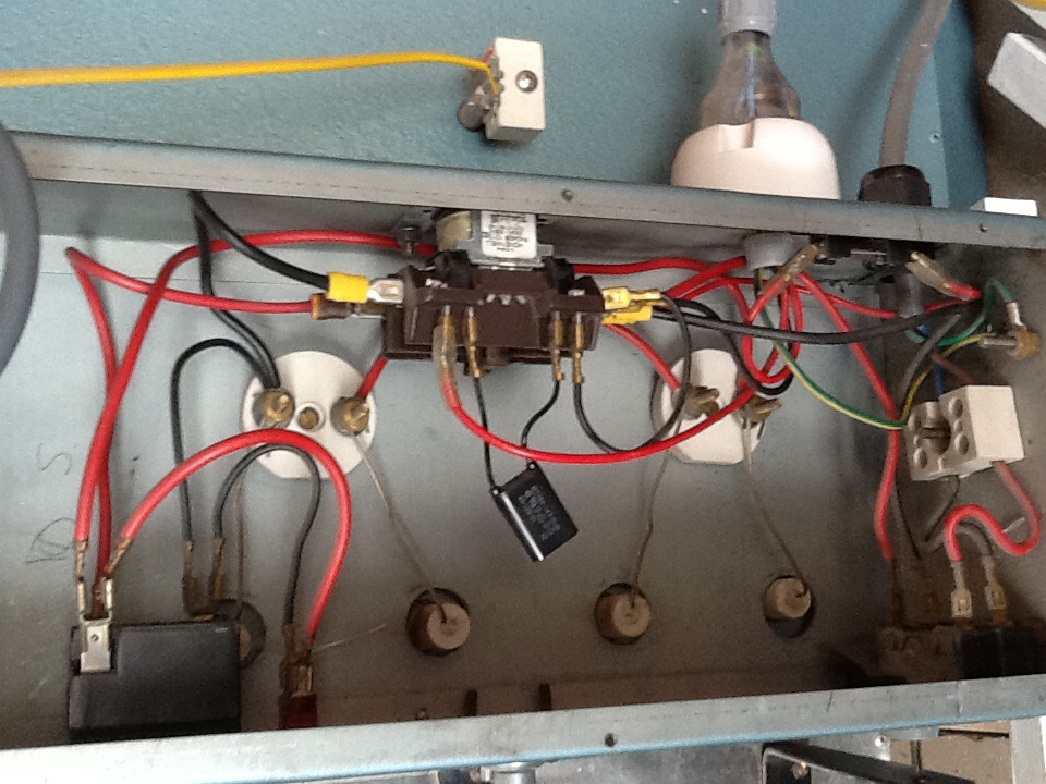

Took the side off the control. I do have two elements and it appears there may be a problem with one of the switches. I will be calling the kiln techs on Monday.

The photos should be rotated 1/4 turn clockwise! The bottom of the kiln is on the right of the photo.

Your safety switch may be out of adjustment. (The safety switch turns off power to the elements when the lid or door is open.) If the safety switch is only slightly out of adjustment, the elements will sometimes still heat at lower temperatures. At higher temperatures, though, expansion of parts can cause the safety switch to turn off the elements before the kiln has reached the programmed temperature.Kim Manley wrote:1 & 2 are being completed successfully, fails on 3 and return an error message (ERR1) that means the kiln has not increased temperature by more than 8 degrees an hour (and in fact the kiln temp is falling).

Thanks Arnold - Tetlow did suggest adjusting the safety switch, and luckily for me the technician was out at one of the local schools, called in and changed the relay over as it was burnt out. Just waiting for the bill (can't actually believe there are still businesses that don't want payment on the day). It is now happily firing (as is my little Paragon test kiln - love it).
