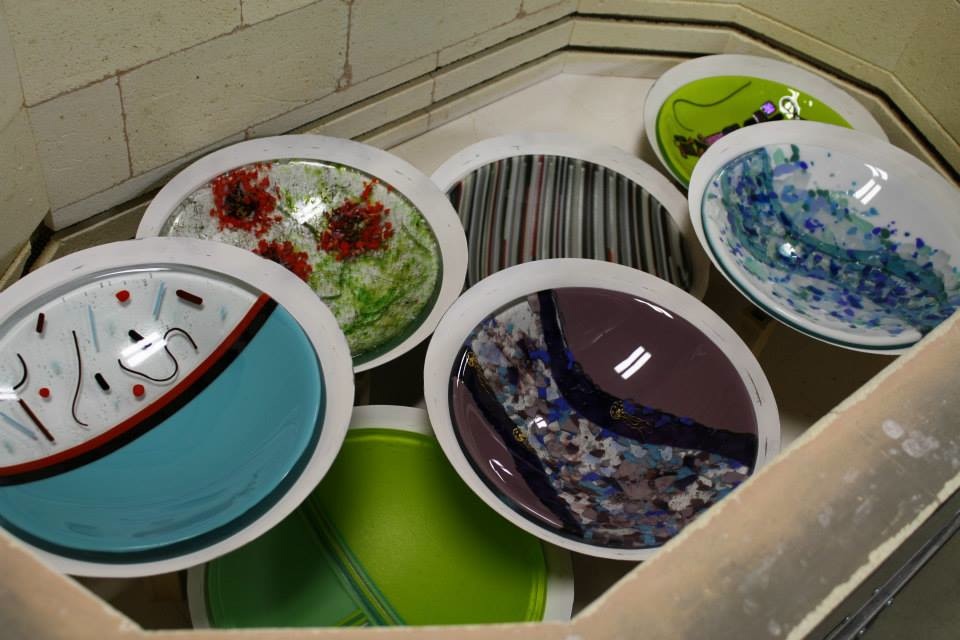

Re: Slumping- number of molds at once?
I saw this photo the other day and made a note of it to remind me that I could slump student work this way. I believe this was taken from a Patty Gray class.
Valerie Adams wrote:I saw this photo the other day and made a note of it to remind me that I could slump student work this way. I believe this was taken from a Patty Gray class.
Yep, that's a Patty Gray class :)
Posts: 1543
The reason this works is that the molds are very gentle, with only a short drop. They're also molds that can stand being overfired or held at a long time at slumping temperature. And they're all the same mold.
If your molds are deeper or steeper, this kind of kiln loading will probably be problematical.
