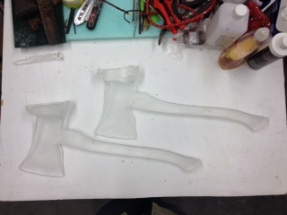

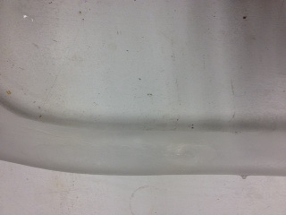

I am having a problem with the glass contacting and deforming the surface in areas. I read on Bullseye to hold art 1250 for an hour when dropping to anneal tempurature but it did not work. Any suggestions?

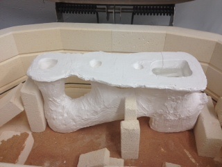

Do you have any suggestions with this mold? My oven is only 13 inches deep and I cast two at once.
Would you make the mold thicker? Or wrap it in fiber blanket?
I built in about 6 layers.
Plaster silica
Plaster silica fiberglass
Wire
Plaster silica four more layers
My end vents filled nicely. The area where the blade mets the handle had some air bubbles even though I had a vent there
I held it at temp for 6 hours and the last hour I raised It 10 degrees to 1570.

Probably I'd rethink the engineering of the mold, especially if you're doing some coldwork to get to the final product.
Can you show where the dimples are occurring, relative to the that picture of the mold in the kiln?
