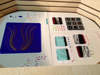

I need some schedule help/advice, please. All my kilns are JenKen - the old kiln is a 16" fiber Bonnie Glo with side elements, my new oval 24x39 has side & top elements. I am attaching a pic of my first fire - all bulleye 2 layers. The 10.5 square was perfect as was the 6" retro square. The aqua coasters were only a little curved on the sides (I had to cold work a bit) and the red & black were extremely distorted and the black glass was overcooked - the color is strange sort of brownish.
first fire.jpg (41.05 KiB) Viewed 20908 times
