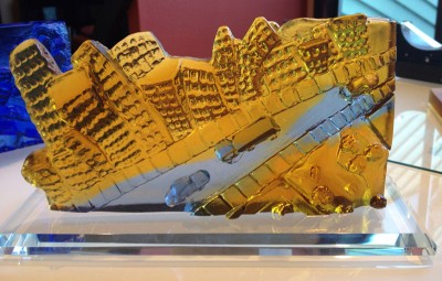

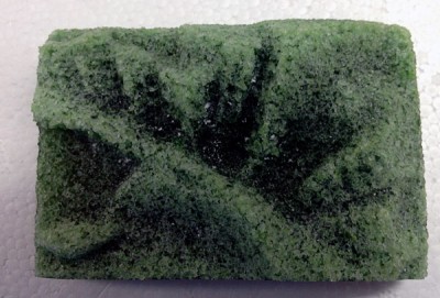

Usually, devit on a surface doesn't bother me much, because I coldwork so extensively anyway. I'm presenting a fresh, clean surface to the heat, so I'm not really giving the devit a chance to grow. When I do get devit, though, it's spectacular. Like this cityscene:
Which SHOULD look like this:
That one, not even coldwork would save. ;-)
