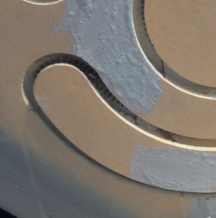

It's pretty bad. There are fissures in the lid and one chunk, that's holding in about 1 foot of coil, could easily be pulled off and is likely to fall anyway. The channel is too narrow for me to get wire in crosswise. I've tried patching it some with kiln brick cement but without much success. Some of the chunks have been about 3/4". Where it looks like the brick is bulging out, the brick is bulging out.
I should have emailed Skutt before posting here and will do that right away.
Meanwhile here are a few photos; this just doesn't seem like it should be normal for a new kiln lid.
[Photo doesn't do it justice.]

This seems to be a recurring problem with kilns with brick lids. I've never had one so am only guessing that the problem might be addressed by revising the way the element is held in the lid. Recently my brick kiln needed the lid rewired. As this is a home-made kiln we just repeated what was done originally and I took photos in case they could help someone else. There has never been a problem with anything falling from the lid.
Would it be possible to do away with the brick in the lid and replace it with Ceramaguard or some other suitable high density fibreboard? I don't know what holds the brick in place in the kilns that are causing so much grief but a slight modification might allow the change. One of the nice things about HD fibreboard is the fact that it can easily be cut to any shape. Here are some photos. This is a rectangular lid but it could be any shape.

It appears from your photo that the "bulging" piece between element grooves has actually fractured from the lid itself.You can see the break up inside the element channel.... could this have been caused from a dropping of the lid??  This will call for major lid reconstruction or replacement. Don

It is difficult to tell from the photos, but it appears that the kiln cement patches have been applied too thick. The coating must be very thin, or it will form little cracks and flake right off. The cracks that form when the coating is too thick typically look like the network of fissures in dried mud puddles.barclayb wrote:Meanwhile here are a few photos; this just doesn't seem like it should be normal for a new kiln lid.
