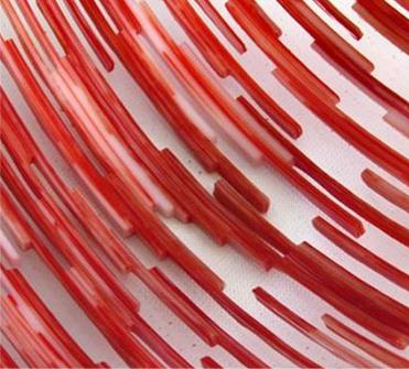

OK, here is a portion of the picture I found yesterday that best describes what's in my head.

You will "always" see a line between abutted clear strips. Why not eliminate strips and fill in design with chunks and frit?

Re: On edge clear strips
It's a matter of degree (heh-heh). It's hard not to have a fine line between clear strips when they're fused together on edge--a small amount of air gets trapped and creates a very fine line of bubbles (and sometimes schmutz, if the glass isn't cleaned well enough).
However, it doesn't always happen, first of all, and second, if you clean your glass well with stuff that doesn't leave a residue, and put a good bubble squeeze in the schedule, the line will be very faint.
Mostly, though, the contrast between clear strips and red opal strips will be strong enough that you'll have to look close to notice what's going on between the clear strips. Did you notice it in this example? ;-)

I think if you filled with frit, you would lose the nice straight lines of the red strips.

A big thank you to everyone for helping. So basically there really isn't a technique to eliminate the fine lines between clear strips other than making sure the glass is super clean without any cleaning residue. That's what I'll do then. Thanks again for all your help!
