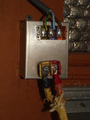

I have just received a new iconel sheathed TC. Prior to ordering it I sent a pic of the current one to the supplier showing the connection to the sending unit. The supplier phoned to say I should immediately replace the existing cable, too, because he recognized it as asbestos-insulated.
Thinking that can't be possible because asbestos mining and the use of asbestos has been banned for decades I looked it up and was horrified to find it's not yet universally banned in Canada, where the TC and cable were originally acquired.

asbestos undisturbed is not a problem. it's only when you move it around or cause the fibers (fibres) to become airborne, does it become a problem. you could enclose the wire sheath, or paint it with a thick coat of latex paint, in order to prevent problems.

Unless you are going to take any of the measures in the previous post, the best thing to do is leave it alone.
If you are going to replace the wiring, coat the frayed end with something or wrap it before disturbing the joint (unscrewing the contacts).

I ordered a new cable which arrived with the thermocouple and plan to carefully wrap the old cable in a damp cloth before undoing each end.
I'd rather not have asbestos in the workshop. It gets quite hot and with doors and windows open there's often a strong breeze. Thanks for the input. Jen

I've not changed one before so expect it will be as simple as disconnecting the cable ends from the sending unit and attaching the new cable which has a yellow and a red end. I believe the new red end will go where the black end is currently attached. If that's not right please tell me. Thanks, Jen.
