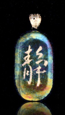

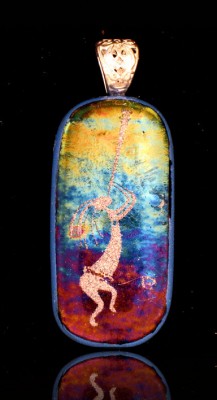

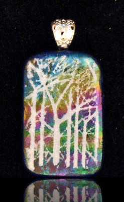

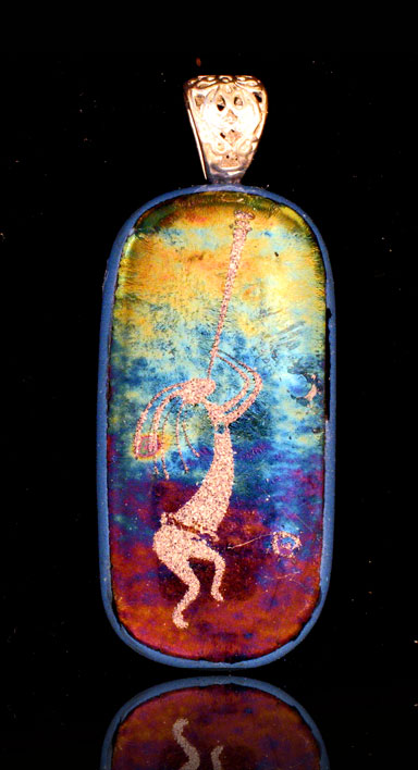

For various reasons, I need to fire irid face-down. Bullseye confirmed that there can be problems firing it face-down onto thinfire, so I did it on a kiln-washed shelf. But...same problem
(markings). Has anyone had this problem and resolved it?

I have been experimenting with firing wissmach irid recently.
I fire both face up and face down. I find that face down is more predictable, but both yield excellent results as long as you don't fire too high.
these are some experimental pieces trying to use mica on irid. Have done more and better on pieces since these, but these pics were available.
