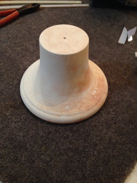

I also had a ceramic stand that the stainless steel former sat on that got covered with glass. It let the glass slide onto the former, and make the ends of the vase turn a bit. It was 5.5" wide at the base, and was like a gentle slope at the end of the former. Do you have any idea where to get something like this?
