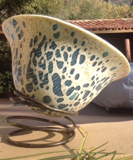

Re: BE ball mold?
I made a coiled steel stand for those totally round bottoms. Expensive and a bit excentric...

Re: BE ball mold?
Thats a very cool idea !Morganica wrote:Well, if thinfire is all you're using, it'll take a lot of it--it's too thin for a single piece to flatten much. Might be interesting to stack graduated circles of it, though....

Re: BE ball mold?
I've seen the stands intended for food, foods like pizza. My stands are thicker, and I can pull them up or push them down and I can create an angle or make them straight up. Truth is there are times I want something that is of a less intrusive design, like what Cynthia does with the marbles.
