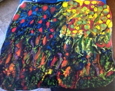

Thanks for the input. I guess I am just too impatient. It takes about 15 minutes or so to get back to the 1600 realm. I thought maybe a torch (Like they use in hot glass) might be more expedient. Here is a pic of my latest experiment. I figure it may take me another year to come up with what I am trying to accomplish. I love impressionist work, that is where I want to be with glass. :?
glass raked   experiment in terror
