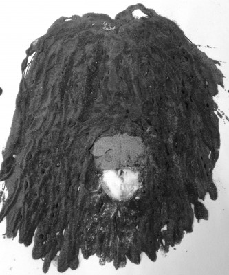

I'm not exactly 'new'. But I thought this question might benefit more than me. I'm trying to use the past conversations to look up recommended firing schedules for using Elmers glue with frit in a drawing. If I input "firing schedules" I find 317 uses of the phrase, but I when I try to define what type of firing schedule I am seeking it doesn't help. Is there a place on this forum where recommended firing schedules are posted/kept? Might that be a feature that people would refer to and use? I noticed a post where a person using rods went to 1425 and had nice results, but if they went higher the rods joined together more and made large holes not present in the lower temperature. I was thinking that most of the mass of my design is glue (which burns off, right?). So the bit that is powdered frit is all the remains. I was inspired by someone else's image of their dog, who looks like my dog. I thought she did it with glass shards, so I began mucking about using all sorts of short bits, but then I saw someone drawing with Elmers and putting frit powder on it and then drying it. So I built up about five layers, drying between layers and now want to fire this mass of glue with frit powder and don't want to over fire it and have it puddle and pool into a large mass of nothing. I want to keep the definition of the layers. So I was thinking of using a variation of the Scutt firing schedule for Tack fusing - Fast. My thinking was perhaps without a long time in the kiln it had a better chance of coming out with the definition I seek. (I can't find the fuser whose work inspired me... I gave up after two hours on the site of Fanatic fusers on FB) I like this venue more anyway, but I liked her work and, as I said, I was inspired to try. I'm not 'afraid' to just hit the firing schedule mentioned, but I also would like to think that it might be successful. Thus the posting.

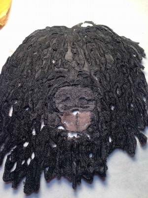

Thank you for the reference. I communicated with an artist who draws using frit. She said she doesn't go over 1325°F and only left it at 1325°F for 5 min. So I amended one of the Skutt schedules (I have a Skutt kiln) for fast-tack and adjusted the schedule's highest temp to be 1325°F. I've attached a photo after my first firing. You can see holes. As the glue burned out it left a lot of holes. I have not seen a video or read how to do this, just someone said put the glue down and sprinkle frit on top. So that's what I did. When the glue burned out it lost a lot of volume creating voids. So I'll build up the image about 3 more times. I have it in now for its second firing. I think 5 will be fine. I am excited to see how this does.
