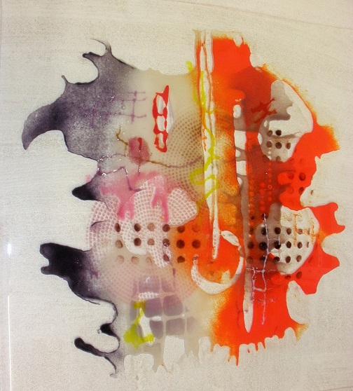

Bellow is something I made recently from wafers.
I like working this way, yet got to learn and experiment more.
In gratitude to all those wonderful people who helped me along the way, with good kind advises, on this board - at the newcomers' thread - I am posting here, something which I consider done. It is wafers, [done separately in several stages] and then, fused to transparent glass
over there, - at the newcomers' -  I posted the first wafer - how it began.
I'd be very grateful for your comments. Please be honest, I can learn from criticism too
many thanks,
HaVi
PS
the wafer on the right side of the piece,[kind of violet] was fired separately first, at 718C [1325F ?] and shrank. Yet, upon being fired to the piece, the holes in it grew, when it was fired. Amazing. Don't know why

Love it!! jen
Re: Working with wafers
I LOVE this piece Havi!

Love the colors and all the texture.  It almost looks like there are faces in profile in there,  but they are allusive.
I really like this piece. It's very balanced and the colors complement each other beautifully.

Hi Havi,
I too like the balance in the composition. I don't see the additional shrinkage in the second firing as a problem. Good old surface tension. If you want to minimize the shrinkage fire the the piece upside down on top of fibre paper. The weight of the glass will hold the wafers in place. You can then sandblast the wafer surface and then refire for fire polish if desired. Flip and fire... one of the great terms coined by the great Brian Blanthorn. Miss his wisdom and humour.
