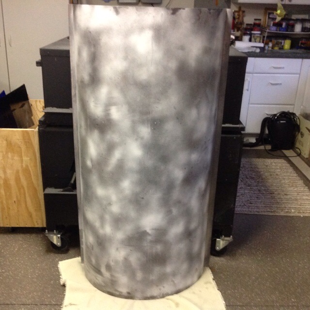

I am slumping a 9 mm piece of glass 51 inches by 24 inches over a stainless steel mold. it cracked at the annealing stage. it formed around the mold well but cracked in several places.
The temperatures I used were 150 degrees to 300 and hold for 15 min.
250 degrees to 800 no hold, 150 degrees to 1100 no hold, 200 degrees to 1200 hold 5 minutes, full to 900 degrees- hold for 5 hrs. 100 degrees to 700 degrees to 70 degrees
I suspect the annealing temperatures were not correct. What do you think?

I don't think your annealing temps are bad. It all depends on the shape of the mold. If your mold has 2 sharp angles as opposed to gentle slopes (such as strait up, strait across, strait down) the glass would be prevented from shrinking as it cools. It must be able to shrink or it will break near the angles. Are you sure it broke post shaping? Was the mold coated with kiln wash? Have a picture?

The mold has no sharp angles. Image jpeg is attached.. I used MR 97 mold release which I have used before with this mold. I have slumped several other pieces of 6 mm that turned out fine. Thank you for your help.

Glass does not crack when hotter than the strain point. So, it either cracked on the way up or the way down. Most likely, it was on the way up, from thermal shock. The glass would then slump and the cracks would widen. If it cracked on the way down, it would just be cracked, and the shape would conform with the mold, other than the amount it changed as the stresses released.
Glass balanced atop a steel mold is pretty prone to thermal shock. The mold gets hot in the place it contacts the glass.
Terry is right on. Gravity is your friend. When draping over, the weight is supported in the middle. When slumping in, all the weight is pushing down. And yes thicker glasses are easier to get to move. Companies that make curved glass for cabinets always slump in, and often they use a dummy piece of glass coated with talc, and the finish piece sits on top of it. The bottom piece will clam up on the edges, as it slips down the mold.

Thank you very much for all of your input. It was all very valuable. I appreciate your expertise. According to my assessment the piece did slump fine and the cracks were clean and fresh. I heard the noise in the kiln after the slump cycle. Would you have any advice on changing the temperatures on the cool down? Is the annealing cycle too long?
