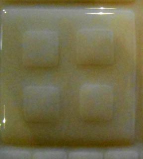

I’m trying to make some items with Bullseye’s French Vanilla (0137). I made a plate, composed entirely of Fr. Vanilla, with a single 3 mm layer base and smaller decorative pieces of Fr. Vanilla, placed about 1/8” apart, covering most of the surface, so that I essentially had a 6 mm thick piece. My goal was to have the characteristic post-firing white edges around each small element to emphasize the design. My first attempt, using schedule #1 below, was semi-successful, in that each decorative element on the surface did have the distinctive white edge, but it seemed to me that some of the smaller pieces were somewhat over-fired so I thought perhaps I’d reduce the process temperature for future firings.
In my next attempt, with 3 new items, I lowered the process temperature and shortened the soak (see schedule #2). The result was that the white edges didn’t appear, but several of the small decorative elements came out very bright white over their entire surface, while the base and remaining elements fired to a deep cream and the whole thing looked patchy. I re-fired these items, using a higher process temperature and adding 2 minutes to the soak (see schedule #3). The white edges showed up slightly this time but the bright white elements still stood out from the creamy background.
I thought perhaps the bright white glass had appeared because I’d used glass from several different sheets of Fr. Vanilla, so for the next item, I used glass from only one sheet and fired it using schedule #4. When I took it out of the kiln, the white edges around the surface decoration elements were barely noticeable.
I know, because I've seen it, that it's possible to produce some clear and distinct white edges, but I haven't been able to do it successfully and consistently. Can anyone give me some clues as to how to achieve the look I’m after? Should I leave more space between the surface elements? Should I hold longer at process temperature? Do I need to ramp up more slowly or add another ramp somewhere in the schedule?
Jennifer

I took some pictures but my camera is not working well so I don't know how "diagnostic" they'll be. Photos DSCN0496 and DSCN 0502 show the bright white elements in contrast to the creamy ones. These were fired using schedule #2 then again using schedule #3. Photo DSCN0500 was fired with schedule #4 and shows the lack of distinct white edges. I don't have a photo of the first piece fired using schedule #1.

Have you tried a small sample, with 2 layers of French vanilla, and then accent pieces and fire a little lower, say 1450?

French Vanilla is one of those weirdly wonderful colors that forms layers of color when the sheets are made, which is what causes that lighter outline you're looking for. I don't think the lighter squares are overfired, I'm wondering if they're perhaps from a different sheet, or the opposite side of the same sheet. I think your middle photo doesn't have the outline because it was fired lower, the glass just needs to spread out a little more. Try it again with your full fuse schedule, and keep careful track of which side of the squares you place up. I'd like to see what happens then.
