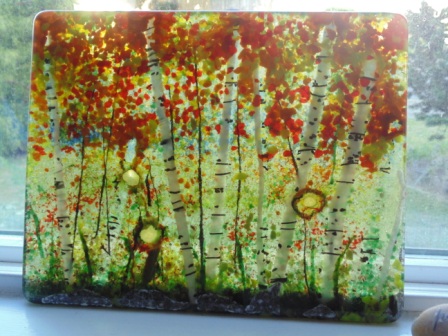

I did this in a Patty Gray 8 x 10 mold. I thought it was going to be fine, however when I took it out of the kiln noticed the 3 "bad places".
 This was done with Bullseye Glass. The problem looks like it is coming not from the very back (I had a solid piece of amber behind and it is intact).
My schedule is as follows:
200 1000 :15
300 1225 1:00
350 1490 :20
AFAP 950 2:30
100 700 Off
Any suggestions would be greatly appreciated.
