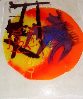

I am nagging, because my issue is, that I use print in addition to working with wafers, and I want to continue working like this [if possible]. It seems to me a bit tricky, as I really progress step by step.
The wafers have their own problematic behavior - they also change while being fired on top of the piece - so I fire them upside down. This creates a surface which is not absolutely flat - which makes the printing a bit problematic - not as I would print on a flat glass surface.
I want to be able to do both processes on the same piece. So I learnt already how to work with the wafers satisfactorily, I need now to know how to add prints to this. I have wonderful screens which had been made for me - I want to use them.
I add a photo of something I made, which is a combination of both processes. [it looks as if it is broken, but it is not]
