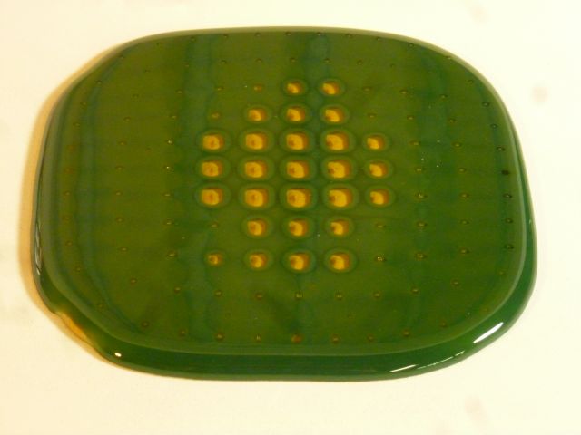

I hope someone has seen this before and can tell me where to look for the problem.
Two bubble-up firings. The first is fine and was slumped into a plate. Next was 4 smaller pieces on the same schedule. All have multiple cracks. The cracked one in the lower right is even the same glass. What happened?
Everything was the same except the size of the glass (7” vs 4 ½”) a different kiln shelf and I noticed the total time in the kiln was 8:02 vs 8:20 for the ones that cracked. Cracks are sharp so it happened on the way down, and some places are really stuck to the kiln shelf. Thermocouple bad? Controller bad?
Schedule:
400/hr to 1100 hold 10 min
AFAP to 1700 hold 45 min
AFAP to 925 hold 60 min
100/hr to 750 off
No problem here
Disaster
Spread out
Disaster! Is this a kiln problem?

The experts were right. Not enough kiln wash. My notes say 8 coats of kiln wash, but my guess is I was distracted with something and picked up the wrong shelf. Thanks for the help. This BB may be one of the best "tools" I have.
As Brad mentioned it takes 1700 to do a Bubble Up. Brad originated this at Warmglass and teaches classes for it. A great class and I highly recommend it. Lots of fun.
Mark
The latest with 8+ coats of kiln wash. No cracks!
Mark
