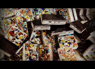

Hello people
I have troubles in edge fire polishing
I use murano glass. I make plates in first firing, then i cut in small pieces with dish saw and the edge stay rough
Then i need to firepolish the edge in a new firing
I tried some times but the edges stay opaque? Maybe any help from antidevit on the edge? Maybe something wrong in the schedule?
Any help will be appreciated
thanks in advance
mike
