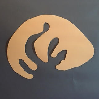

I want to make a piece , whose contours on one edge are completely curved. I want to do it strip-fusing.
It must be dammed, but I am not sure I know how.
I was thinking of making a dam from 1/2" fiber board. But I know that this thickness of fiber board is insulating, and probably will cause a thermal shock at the edges of the piece. It happened to me once...
Is there another suggestion???
I'd be more than grateful to consider.
Many thanks in advance,
