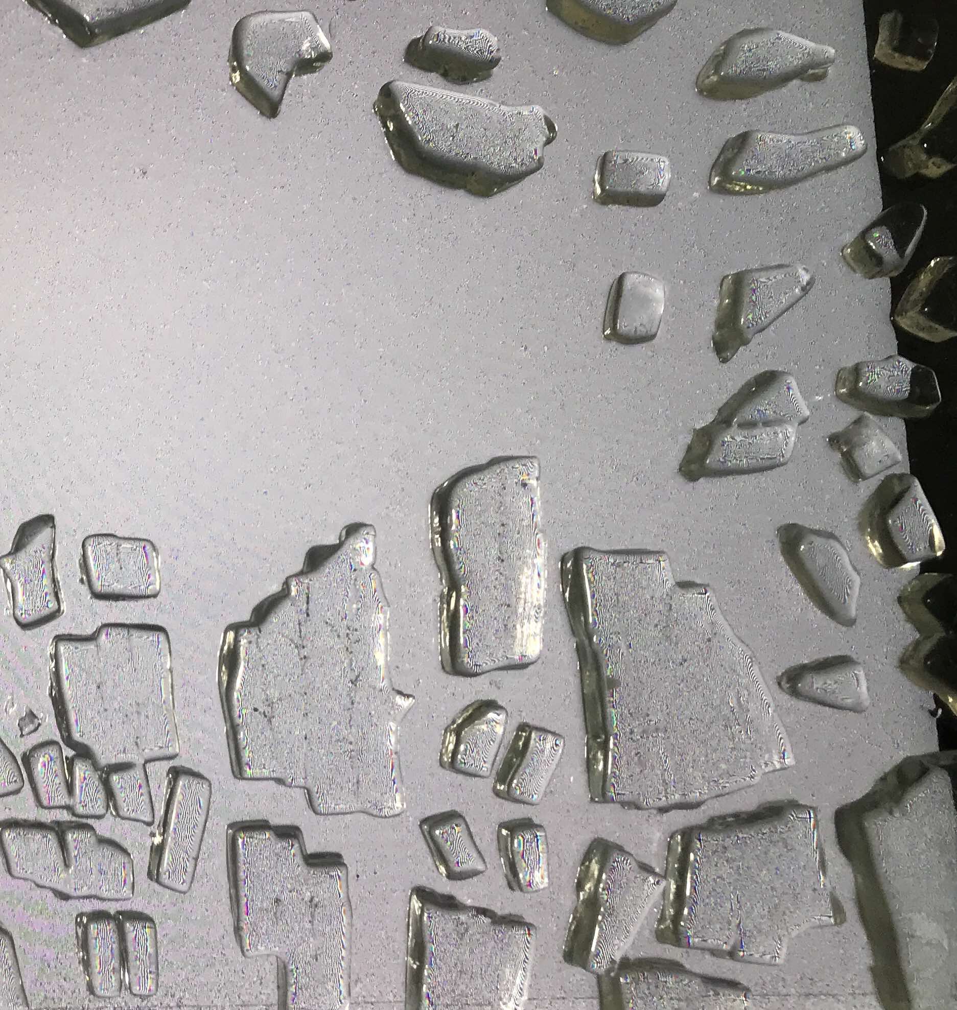

I've fused tempered glass shards and chunks onto a small (6X8) piece of picture frame glass. It fused well, but when I look at it through my DIY polariscope (glass on top of LED screen, viewing through a polarizing camera filter), I see a very thin band of rainbow right along the edges of each tempered glass piece. There are almost no rainbows within the chunks of tempered glass that are cracked but still together. I can see the rainbows even without the polarizing filter when I hold it over the LED screen - here's a photo:

It's almost certainly incompatibility. It's a good practice to only fuse float with itself, rather than fuse one piece of float with another. In time, the piece will probably crack further.

In case my post wasn't clear.... there are no cracks at all in this piece. Only lines that show where the tempered glass chunks cracked when I deliberately shattered it. I kept those chunks intact in the design and I am glad that the lines are still visible.
I want to be sure I understood the rainbows. Rainbows showing in a polariscope indicate stress in the glass, so that would be where the glass MIGHT crack in the future. Am I correct about that?

Yes.FusedLightStudio wrote:I want to be sure I understood the rainbows. Rainbows showing in a polariscope indicate stress in the glass, so that would be where the glass MIGHT crack in the future. Am I correct about that?
I assume by "rainbows" you mean bright white areas of stress, usually around the corners of the pieces that are incompatible.

Well, no, they are rainbow-colored. I think you can see them in the photo that I attached if you blow it up. They are just thin bands of rainbow around the edges of the tempered glass that's fused onto the pane glass.Brad Walker wrote:

I can't see what you're referring to, but I'm wondering if the polarized film isn't quite oriented right. The two lenses need to be turned so that they don't let any light through. Everything should look black except for any areas of stress.FusedLightStudio wrote:Well, no, they are rainbow-colored. I think you can see them in the photo that I attached if you blow it up. They are just thin bands of rainbow around the edges of the tempered glass that's fused onto the pane glass.Brad Walker wrote:

I know this is an old post, but I think those rainbows you're seeing are just the pixels of your screen being magnified/distorted by the edges of the tempered glass pieces.

Oh, interesting point. Thanks Glass Fever!Glass Fever wrote:I know this is an old post, but I think those rainbows you're seeing are just the pixels of your screen being magnified/distorted by the edges of the tempered glass pieces.
