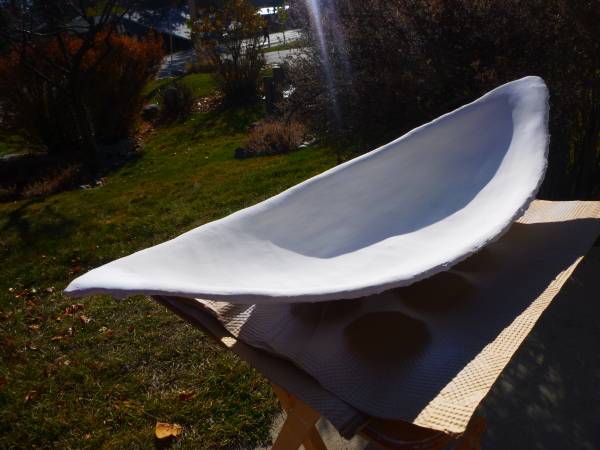

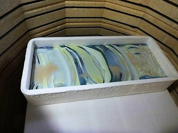

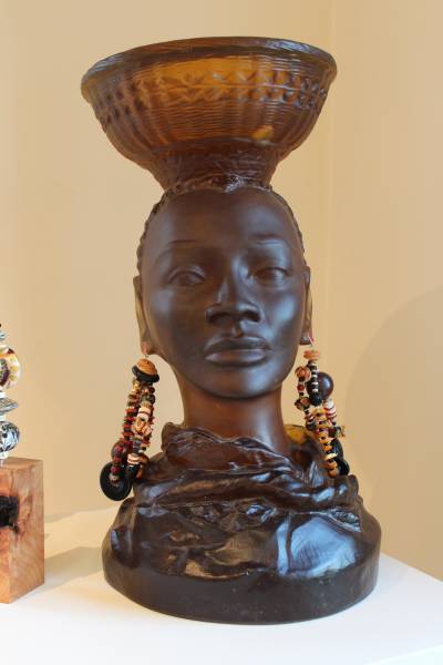

I have worked with Mold Mix 6 for years. I like the MM6 as it is not in powder format . What is the shape you are trying to cast . Mold Mix 6 can get very hard if painted on tooo thick. I like it for soft and sensual shapes . But once you get used to using it , you can use it in most shapes. But I use Bullseye Kiln Shelf Primer as a release Poured into mold and poured out quicky. Are you painting on to wax . If so use Universal Spray Release on the wax for a good release . I do not suggest steaming out at all but carefully burning out over a rack and water underneath. Be very very careful NOT to catch wax on fire while slowly melting wax out. Then cure the finished mold in kiln up to 1500 Deg. F. It does not thermal shock so you can go quickly to top temp. ( then pour in Kiln wash ) ( and then dry well at 400 Deg. F. ) If done correctly you will get a really lovely finish with NO cold working.
Re: Mold Mix 6 or 7 ????

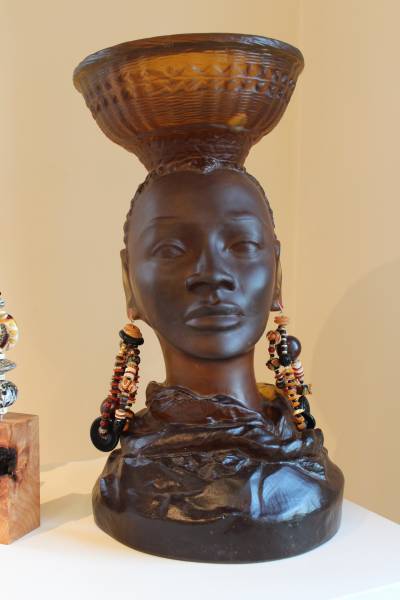

Here is how the piece should come out if done right. http://www.twinvision.fusedglassartists.com/ The full sized head was cast in MM6 nestled in sand for backing !
