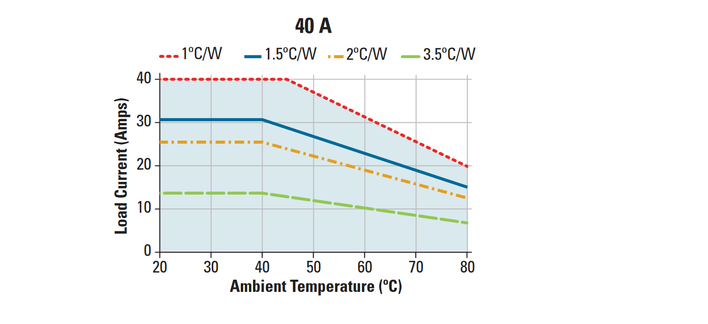

Ed Cantarella
Posts: 155
Re: SSR question
Post by Ed Cantarella »
I always use SSRs rated for at least 3 times the load as their real life rating drops quickly with a rise in ambient temps - see the pic. And the higher capacity is a trivial amount more imo.
