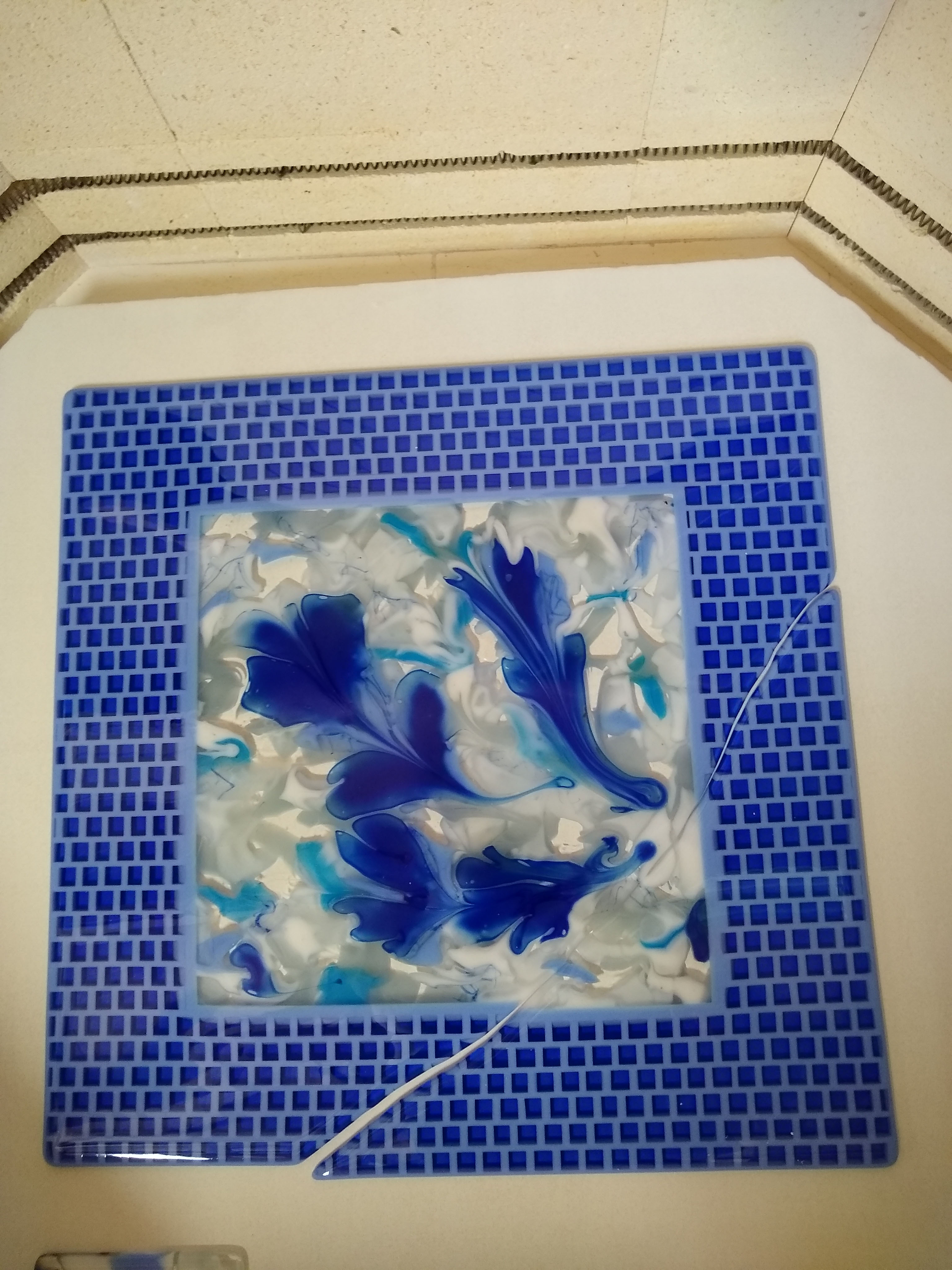

Cracked during heat up
I need some advice… I had high hopes for this piece, but it cracked on the way up during a polish. The edges of the break were rounded and partially fused back together. Hopefully I have successfully attached the photo. It had a combed center and pattern bar sides. I’d like to try it again, but I’d like to avoid another break. The piece is 16” x 16”, all 96 glass, but by Spectrum, Oceanside and Uroboros. This firing was on a corelite shelf with no dams. The piece has some variation in thickness, 3/8” to 5/16. There is no sign that the glass stuck to the shelf, and no sign of problems during the previous firing. No sign of operational problems in the kiln. Below is my firing schedule. The previous firing had the same annealing schedule except the last segment was 100 to 300. Thank you for your help!
60 300 H10
60 800 H10
60 1050 H10
200 1390 H 10
9999 960 H4 hrs
9999 850 H 2 hrs
80 300
Thanks, Sandy
60 300 H10
60 800 H10
60 1050 H10
200 1390 H 10
9999 960 H4 hrs
9999 850 H 2 hrs
80 300
Thanks, Sandy

Sandy Pendleton
- Posts: 16
- Joined: Thu Jul 12, 2012 11:42 pm
Re: Cracked during heat up
this is the photo
Michael Stevens
- Posts: 83
- Joined: Thu Dec 26, 2019 2:52 pm
well looking at your schedule seems slow enough. I usually allow more time when have glass with different qualities, opaque and transparent. if you have lots of bubbles in the glass, or thick and thin fused Together.
I vent my kiln little bit on heatup to 500c that always reduces thermal shock in. my kiln. but if I made bubble glass or other sensitive piece it's not easy.
the look of the crack doesn't seem to be incompatible between different companies glass.

jim simmons
- Posts: 478
- Location: Hillsboro Oregon
It does look to me that it is an incompatibly problem.
Maybe some of the glass shifted in the combing cycle.
I have had that happen to me before.
There is a lot more than COE involved in the heating process.
I suggest that you stick to the same manufacturer.
I also suggest that you read the BE article on COE vs compatibility.
The other Jim
The other Jim
Sandy Pendleton
- Posts: 16
Jim,
Thank you for your response. I have suspected this might be an incompatibility problem, but I don't know how to tell for sure. I thought maybe the break would follow the color boundary. I have read the BE article. I have done lots of combings over the years with 96 glasses, but this is the first time I have included Oceanside white. It looks denser than the old Spectrum white, and perhaps it is stiffer. I haven't heard this is a problem in 96 land, but I am suspicious.
Thanks for your help,
Sandy
Sandy
I think the coe changed as well. That and the Oceanside glasses are different in some ways than the Uroboros
I understand you observed the piece cracked on the way up, but I would think too about the anneal cool segment you’ve used. I think 9999 from 960 to 850 is too fast, especially with a piece involving multiple firings. You may be retaining stress with each firing. I’ve done a lot of combings with white glasses, which present challenges, especially with multiple firings and when combined with transparent glasses. An adequately slow anneal cool segment is Important.
I always hesitate to publish my schedules for high fire and challenging compositions, because my experience/kiln is unique to my work. Still, I think once you eliminate the compatibility questions, I believe slowing your anneal cool segment would be helpful.
If I was adjusting your schedule, I would slow the cooling segment after the 960 hold 50 dph and take it all the way down to 800, eliminating the hold at 850. Then I would cool at 100 dph and turn off the kiln at whatever temperature you are comfortable leaving your kiln to cool on its own.
Hope this helps. PM me if you’d like.
Good luck! I know how frustrating it can be trying to diagnose these types of problems.
