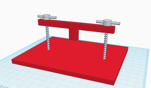

Here is a sketch of one possible clamp style, many are possible...[img]
[/img]
