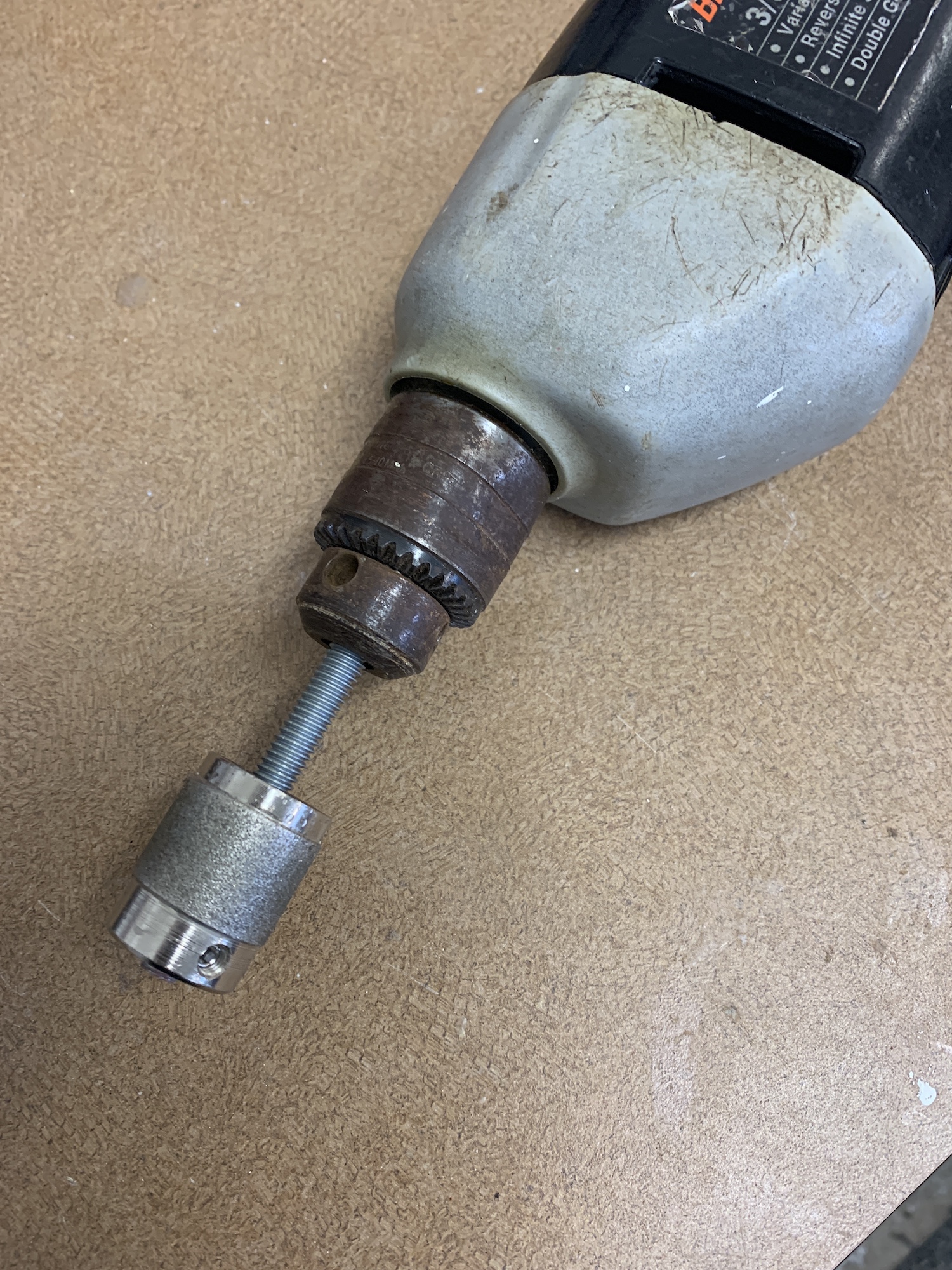

Hi All,
A client who is across the country has to trim down a small section on the side of a wall piece I made for her.
Is there a way to have an Aanraku bit, which fits on a grinder, work on a hand held drill? There must be an adapter that will fit in her drill and will hold the bit (?)
Thanks!
Bonnie

You'd need a small steel rod with a flat side. The rod would go into the bit and then the allen screw would be used to tighten the bit to the rod. You could just find a diamond bit that is designed to fit in a drill. https://www.harborfreight.com/diamond-r ... M6EALw_wcB

I agree, and was going today to look for a rod or wooden dowel and cut it to use. I am surprised the bit manufacturers don't have such an adapter!

I use a cordless Dremel with a diamond bit from Harbor Freight, in a shallow pan of water. Cordless will keep her from getting shocked - water on bit and glass will keep it from heat shock.

Because this is smoothing down the side of 1/4" flat glass, I want it to be super easy for the client. That is why I am sending her a 1" diameter Aanraku grinding bit. Easier to control than a smaller bit. I am suggesting someone spray water on the glass as she grinds it down. (I will make her a video to watch how it is done).

I made a video for her, with explicit details. and she did it successfully!
