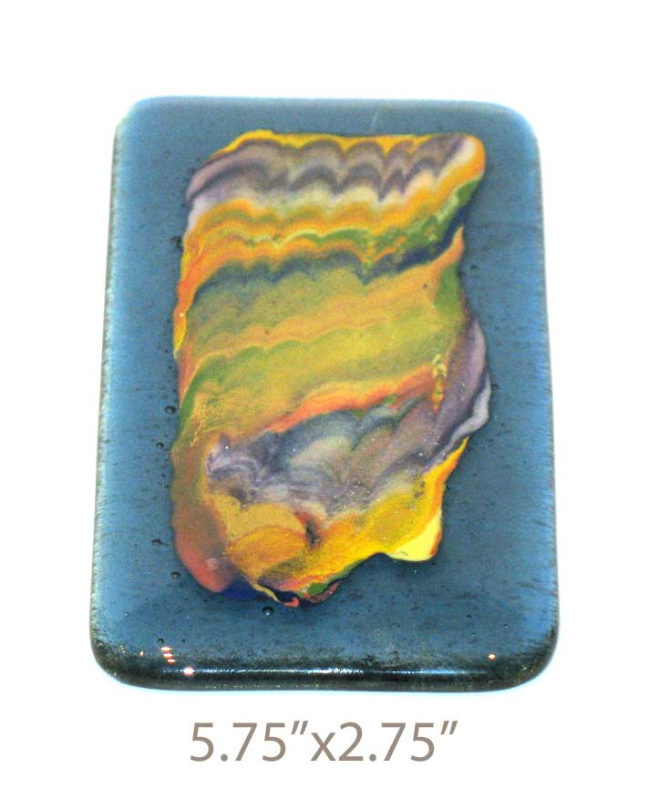

Can you mix dry enamel with clear powder to make custom colors?

I have been using clear glass flux that is waterground and mason ceramic stains to do printing and painting work for many years. It is a little less transparent than straight glass enamels but it gives one a broad palette. I get a large bag of the clear flux which is a fritted glass powder and then I can get the mason stains from my local ceramic supply place.

The fluxes that I use have a melting point of around 1000 degrees. The addition of the ceramic stains raises the melting point of the mixture. The mixture's maturing point depends upon how much stain is added to the flux. I find that I get results at temperatures from 1250 degrees to 1350 degrees.

Heck yea you can combine enamel or stains with powder.
I do it all the time.
