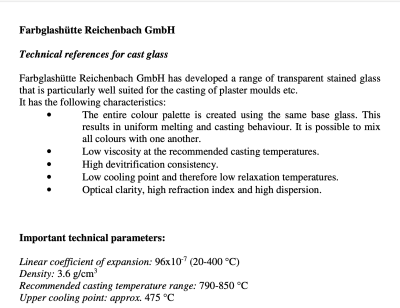

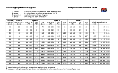

I also have some Reichenbach clear billets I'd like to cast, and usually use Bullseye. According to Olympic Color Rod in Seattle, the COE is 96, and the percentage of lead is 15%. I found these two forms on their website: But surely there are people out there who do this more regularly and have a useful schedule to follow.

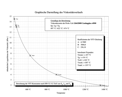

Hi Again,
I just found this! Also on glasscolor.com
