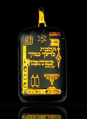

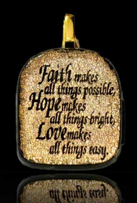

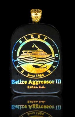

by Barry Kaiser
I have looked at decals made from both laser printer ceramic toner and screen printed enamels. The screen printed ones are far better than the laser printed ones. I think (with nothing to back it up but observation) that the laser enamels are diluted with come type of carrier.
Screen printed enamels are the way to go if you with good decals. The problem is that the designs are limited to those available for resale.
We screen print (or photopolymer etch) to get wording. The price is such that it is cost effective to make only one piece. And screens are reusable many times.
Here are three examples:
Faith
Faith
Belize Aggressor
Belize Aggressor
Ketubah
Ketubah
