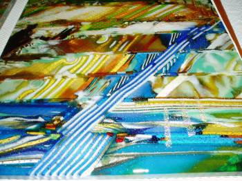

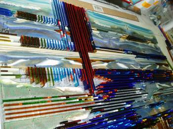

Posted: Thu Jan 23, 2014 1:02 pm
by twin vision glass
New panel fired in a friends kiln . She is so kind and helpful and generous and makes the ulitmate wheat free meals and brownies. Thank you Katherine Russell and welcome back to Canada after years in Australia.
Re: New Slump MOLD
Posted: Thu Jan 23, 2014 1:06 pm
different panels that go together . AND others in various stages of creation. Lots of frit and 7 layers of glass . I had to drive for 3 hours in snow storm to fire these too!!! so it was a trick to have the whole million pieces NOT slide around. I love lepages white glue. Just a tiny dab on outer edge of each piece holds it all in place. [-o< BUT over a few bumps in the road I was definately doing this 8-[

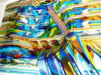

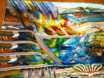

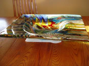

Re: New Slump MOLD
Posted: Tue Jan 28, 2014 11:19 pm
I have used the slump mold again but with a slight different shape as the client only wanted it slumped 4 inchs deep instead of 8 inchs deep. I carved a piece of fiber board and put it in the bottom of the mold with Vent holes and it really slumped nicely. I am very glad the mold is still going strong. This piece is 25 inchs by 19 inchs x 4 inchs deep.

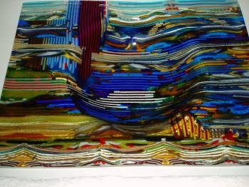

Re: New Slump MOLD
Posted: Wed Jan 29, 2014 11:38 am
Thanks Sue and Orritlandau,
The clients want 3 that will span the length of their lovely large beautiful wood table. (they felt lower was better for them with more flat area due to to the length of each piece.) Now the trick will be to get each one EXACTLY the same slump. I took alot of notes so hopefully the next will follow the same schedule nicely. Les

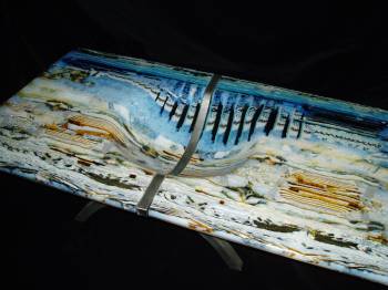

Re: New Slump MOLD

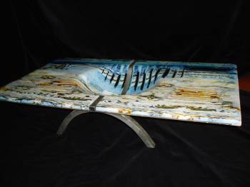

Posted: Wed Jan 29, 2014 4:01 pm
Sorry for this not great photo but Rick Wilton might appreciate this as he helped me grind it. Thanks again Rick. The base is simple and nice. And thanks Tammy for your kind words. The piece is called "GLACIERS"
Les

Re: New Slump MOLD
Posted: Fri Jan 31, 2014 3:34 pm
by Warren Weiss
Hi Les,
Beautiful! Is the metal bar on top of the glass to hold it to the base, or is it through the glass creating sections? Thanks.
Warren
Re: New Slump MOLD
Posted: Fri Jan 31, 2014 4:46 pm
Through the glass ,making 2 sections that sit on two long full length metal square lengths that span the whole piece. (which is really nice for transport tooo!) as the piece comes apart and is smaller for shipment. Les

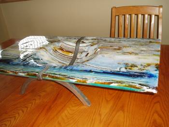

Re: New Slump MOLD
Posted: Wed Feb 05, 2014 4:53 pm
Hi!!! I had a request to show how the stand was made for the 2 panel piece. AND here is another of a 3 part series of vessels . Goodness I pray for power and enough of this 29 Below C. weather we are having even though it is bright and sunny BUT definately freezes the eyelashs and spoils one make up . :-k
