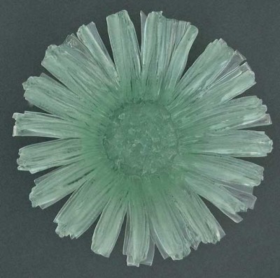

What Laurie says is correct.The one safe way to play with recycled glass is to use the glass from one bottle or one window pane, you know those are compatable. Below is a piece I recently made using recycled window glass.

Gorgeous piece, Bob.
